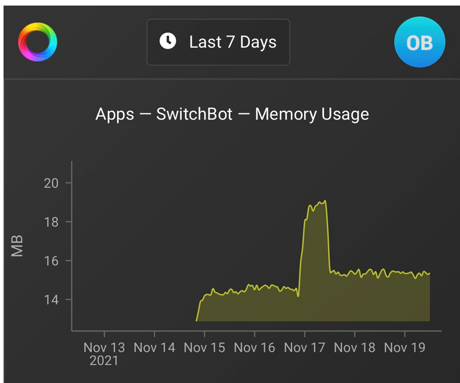

Homey has crashed now, what logs do you want?
I had to plug out and in the power.
Could you go to More > Apps > Switchbot > Configure App, then select the Log tab and send the log in there.
Also could you check the memory usage in Insights.
Log has been sent.
Here is screenshot of the memory usage for last 24 hours and 7 days.
bilde
bilde
not the best resolution but hope it works.
I can’t quite read the numbers on the scales but they look very large.
The app normally uses about 18 MB or so.
Ah, I have just seen that is the system memory. Could you look at the SwitchBot app memory used?
The log looks perfectly normal, no errors in there.
Could you try the test version as that had a lot of changes.

Here is a better picture. but this is from the system and not the one app.
bilde
The system memory doesn’t tell me what the Switchbot app is using so it could be anything using that.
I really need to see what Switchbot is using to see if it is a problem.
Found it, sorry!
That looks reasonable. Not sure about the spike but it’s not using excessive memory.
I guess if you have a lot of apps it could just push it over the top.
