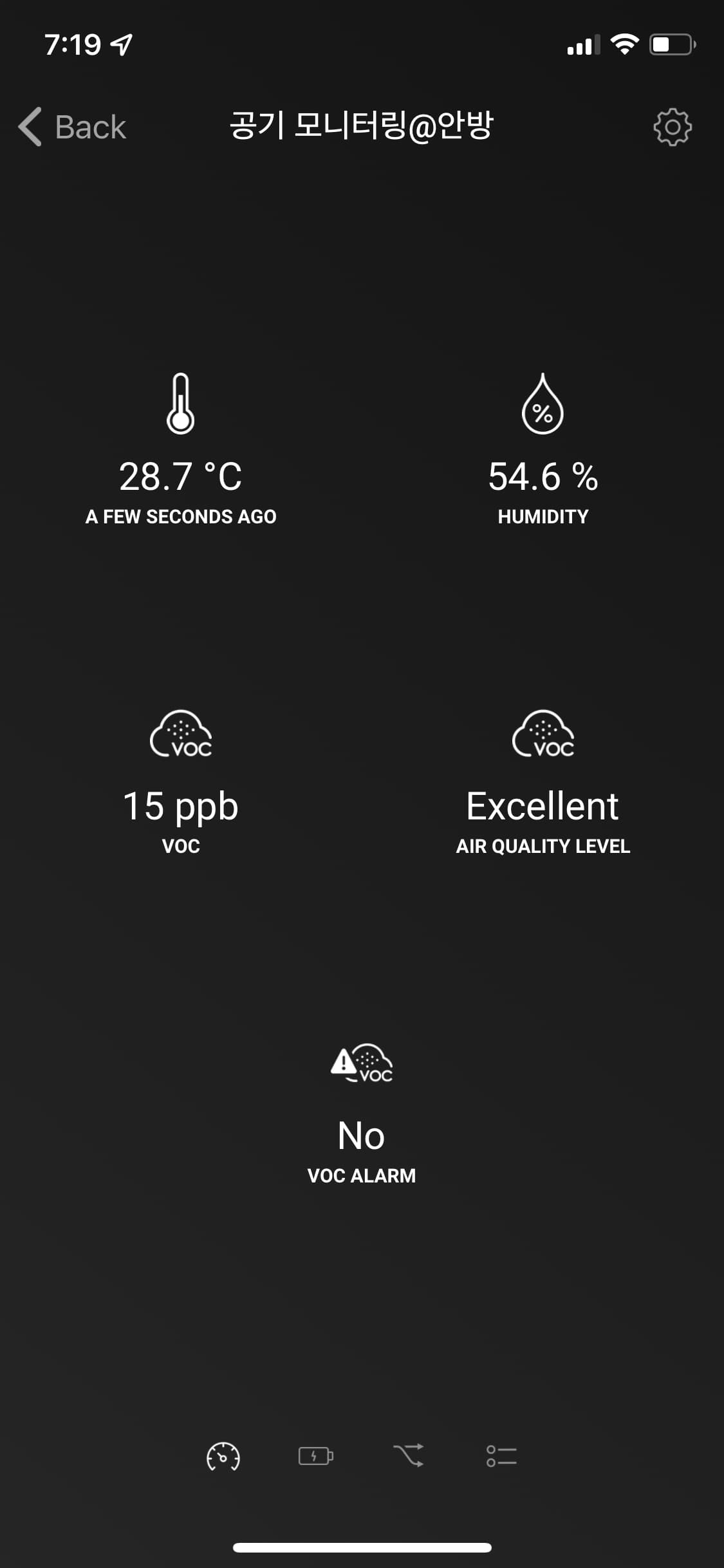

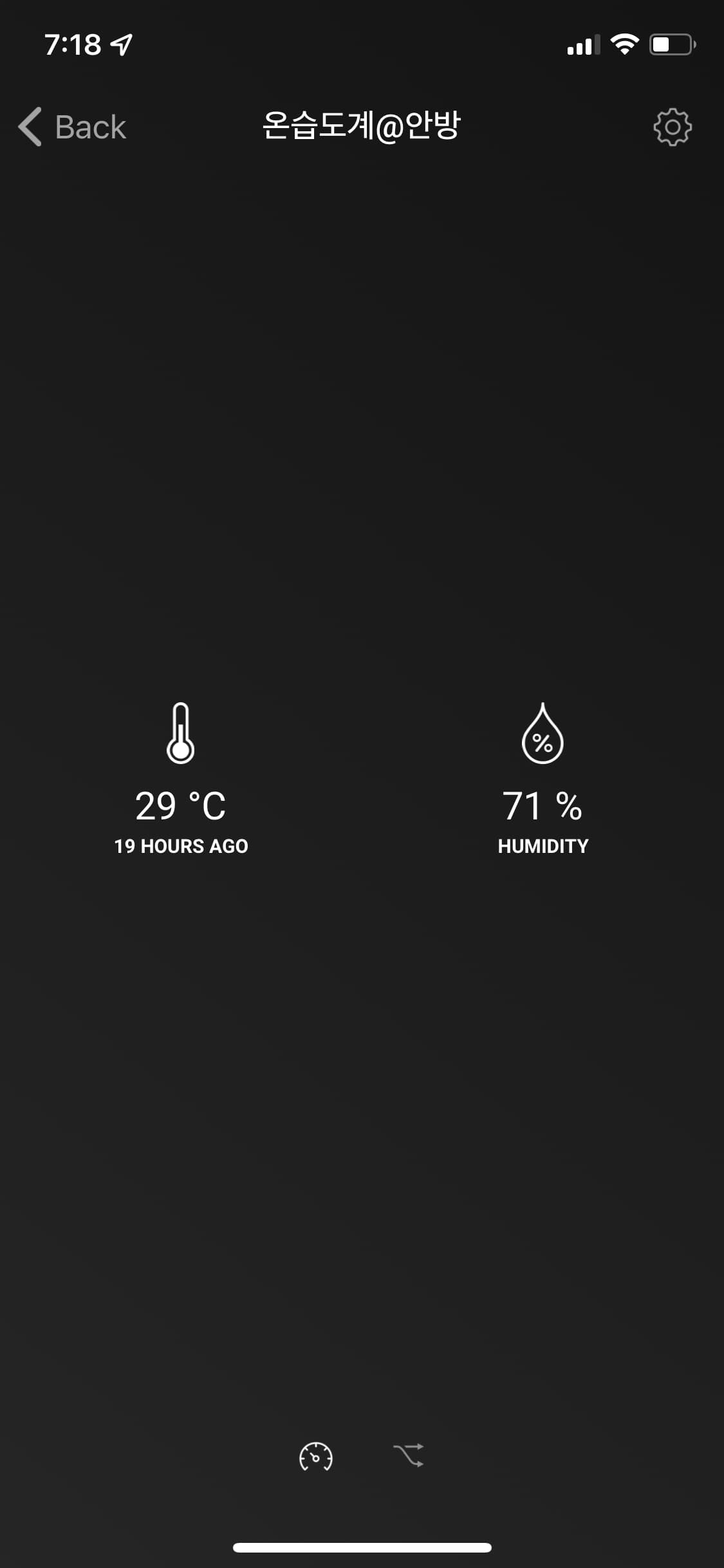

I still have update problem with a thermometer through cloud. It is not being updated for 19 hours.
BLE connected thermometers are OK.
Attached images are thermometers in the same room. First one is Aqara zigbee connected and the second one is the cloud connected switchbot one.
Could you got to the More > Apps > SwitchBot > Configure App. then select the log tab and set the drop list to “Detailed Information”. Then wait for about 30 minutes so the log can capture some data and then tap on the Send Log button. Hopefully that should show me if the app is trying to get data from the SwitchBot servers.
I have sent the detailed log of about 30min. Let me know if you didn’t get it. Thanks for your effort.
I have the log and it is not showing any attempts to get the device data from the hub.
How many hub connected devices do you have in Homey?
The app will poll the API every 8.7 seconds * the number of devices.
The BLE is working OK so it’s not a complete app failure, therefore something must of upset the timer. I will investigate and let you know.
In the mean time, if you restart the app does it start updating again?
Oh… I see. I have 7 switchbot hubs in operation. So I have to set at least 8.7 * 7 secs for polling interval. Thanks for checking.
It’s more about devices rather than hubs. So if you have added, say, 2 temperature modules, 4 curtain motors and 2 switches to Homey via the HUB drivers, then that would be 8 devices.
The app takes care of ensuring the polling interval you enter is not too short using the 8.7 seconds * the number of devices rule. So even if you entered 8 seconds for the polling the app will just override that.
