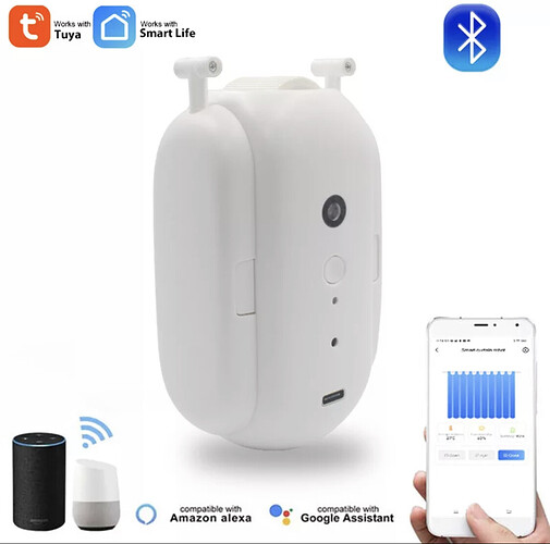

Your app work with the curtain of Tuya BLE ? Is the same, only the brand change.
I don’t know. I haven’t tried and I’ve not heard from anyone. I don’t think they are compatible but that is just speculation.
Here is the model

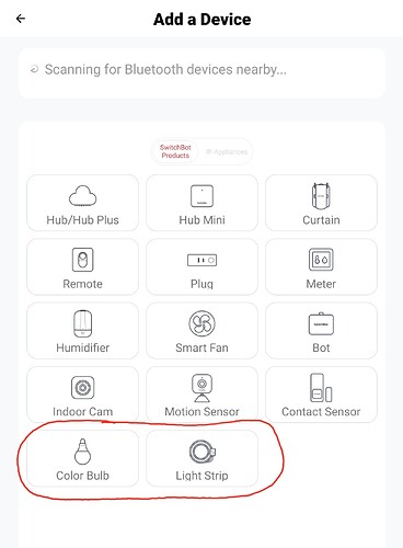

It seems like there will be two new Switchbot devices coming soon.
I have seen the references to the Colour Bulb in the API but not the light strip. Maybe it uses the same commands / status.
