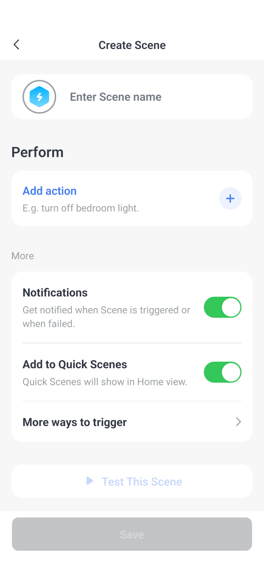

Unfortunately scenes don’t send notifications, so there’s no way to know when they are run.
Hi there seems to be a toggle for notification on a scene.
But that doesn’t come through the API.
A check thanks!
