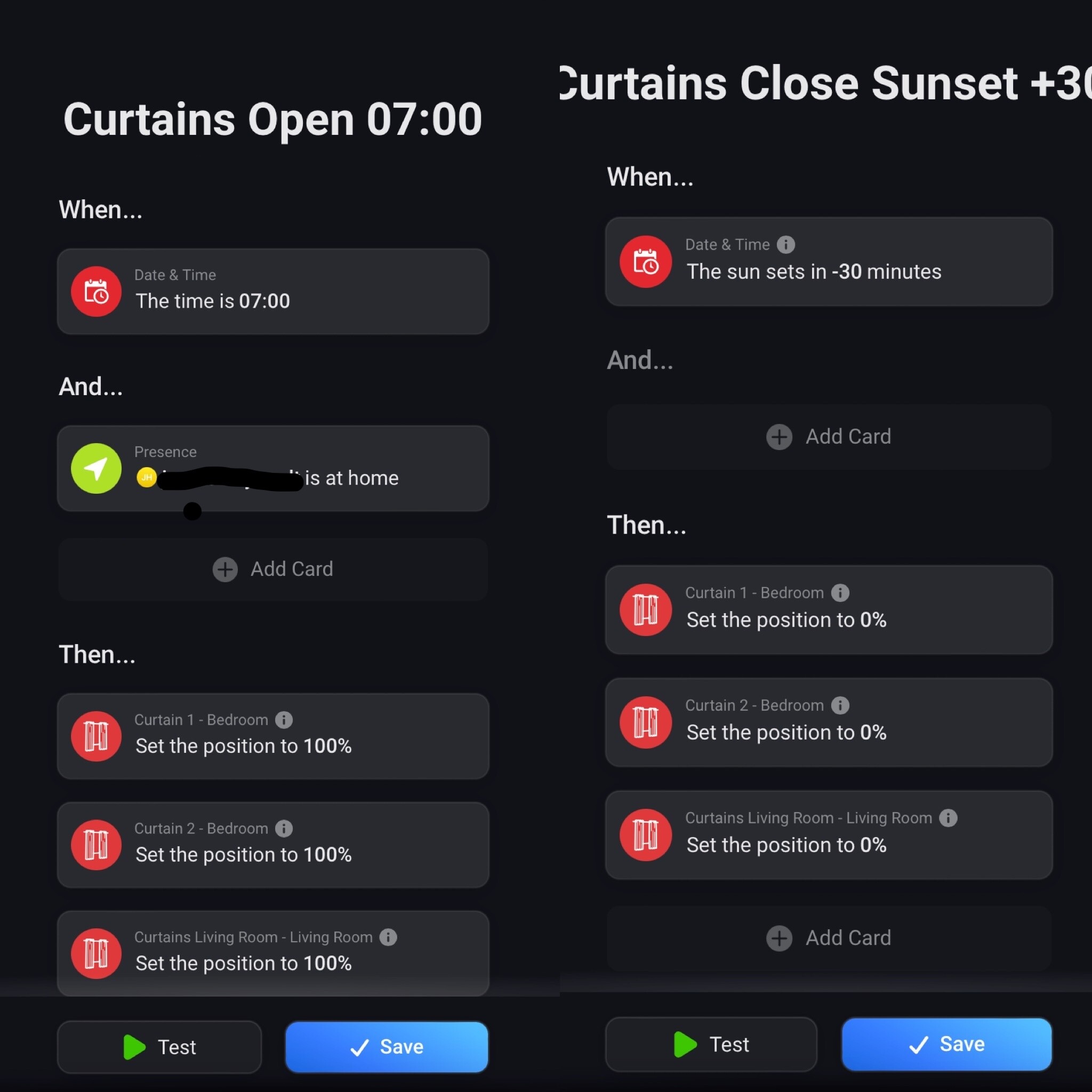

I have both Blind Tilts and Curtain 3 in my home. I have connected them in Homey Pro app via Hub (web log in).
I run 4 flows. One to open curtains at 7am. One to close the curtains at 30 minutes after sunset. One to open blinds at 7:30 am and one to close the blinds at sunset.
All but one flow works. The close blinds at sunset. I am at a lose trying to trouble shoot this for weeks now. I have added a notification tag in the flow so I know it is triggered correctly. I have tested the flow and the blinds close so I believe I have the settings right. Any ideas? Like I said they open, but just won’t close. I can control them manually and they work so connections working.
Any ideas?
The only thing I can suggest is to check the Log in the app settings. maybe enable it a bit before the Flow is due to trigger and keep an eye on it to see if anything is logged around that time.
