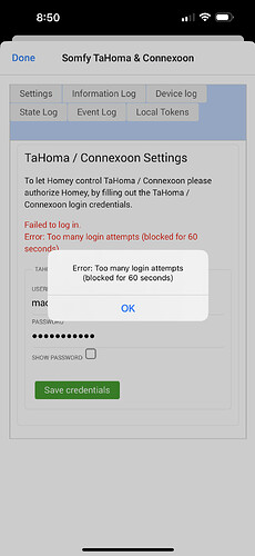

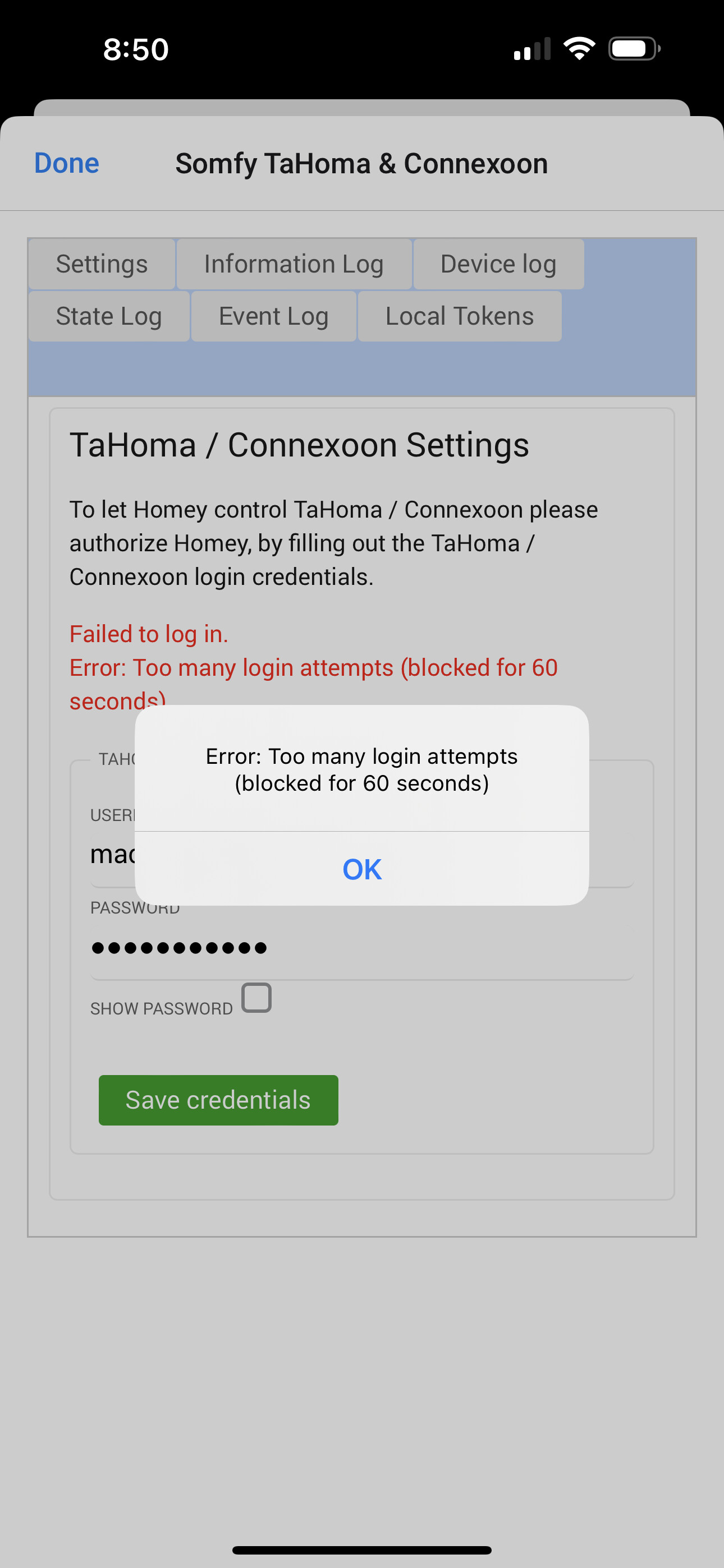

Hi Adrian, I have attached the log file and a screen shot of the message that I get when attempting to login.
I have tried to login on the somfy.com.au site and I can login with no problem if I got to the somfy .com site it fails to login it tells me that username or password is incorrect .
Below is log file recorded as requested hope this helps .

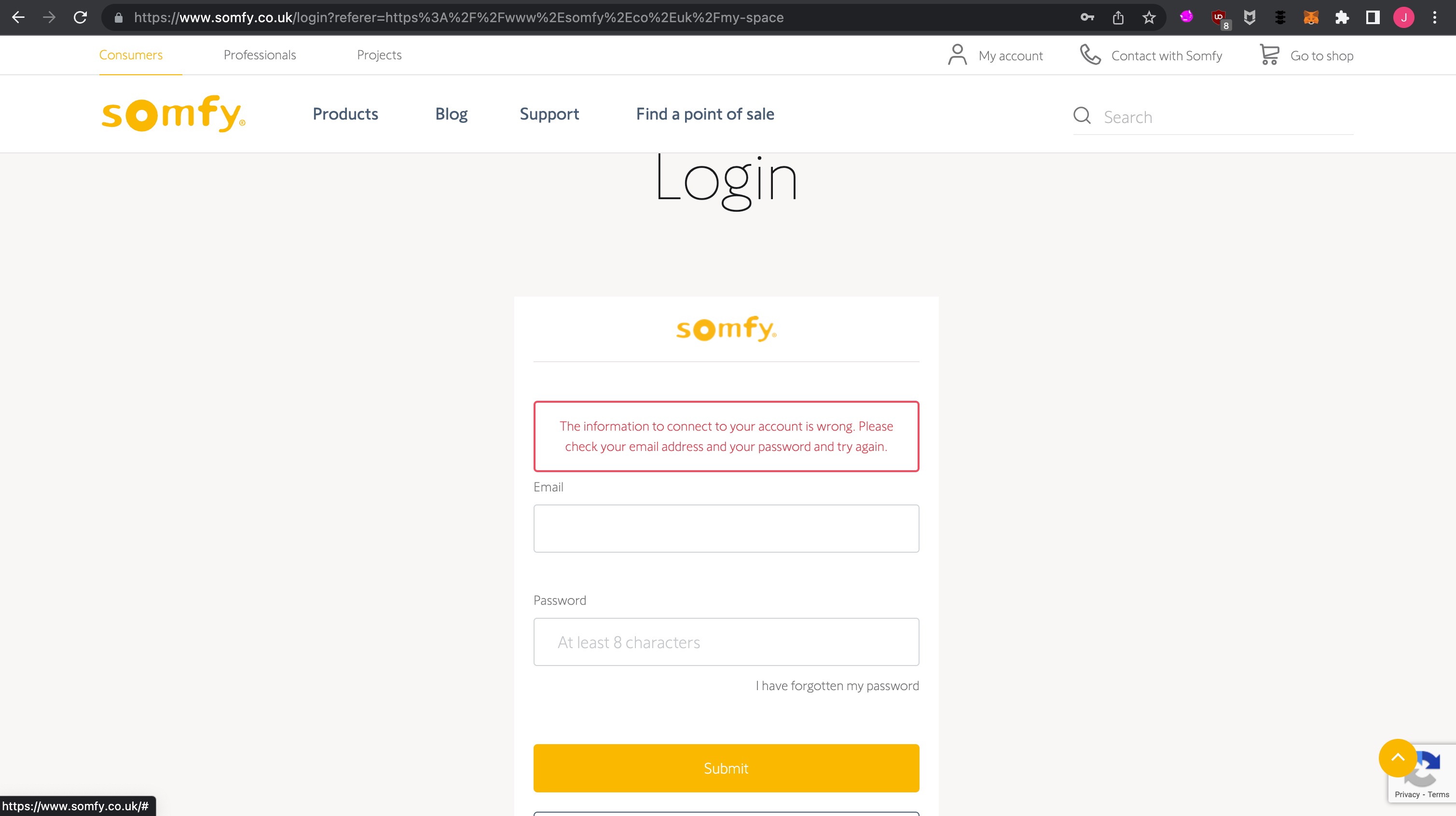

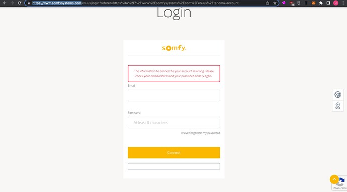

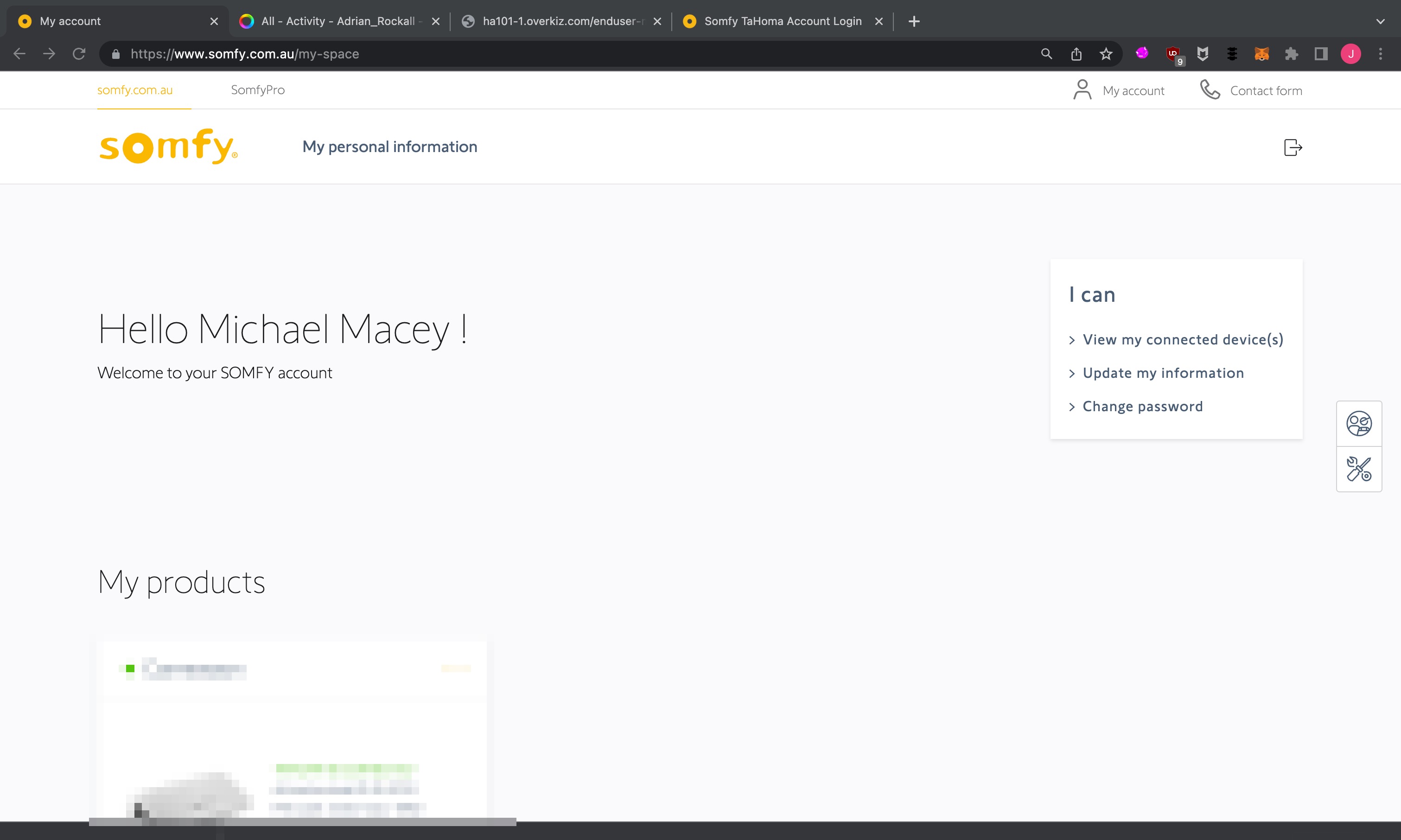

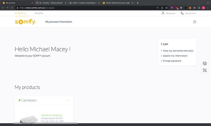

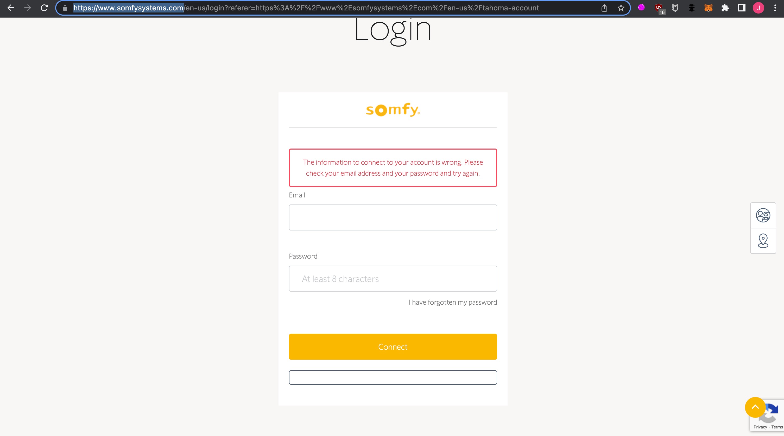

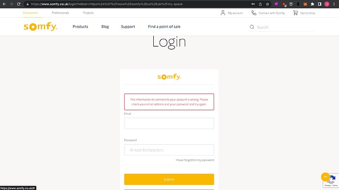

Hi Adrian the Somfy accounts for Australia are on the domain https://www.somfy.com.au/ which I can successfully login to. But when I try to use the integration in homey the login fails with a 401. I have a feeling this is because your integration doesn’t support that domain and only supports the USA domain of https://www.somfysystems.com/ which Australian accounts cannot login to.
I also tried logging in via the UK domain but the same result as the USA domain.
I’ve attached screenshots showing the result when attempting to login via the other domains
As I said above, the API doesn’t use the normal Somfy URLs, it uses a global Somfy API URL. This has worked for many years for many 1000’s of users, so it is possible you are the first user from Australia but I doubt it. I will however ask my Somfy contact to verify that.

I have just tried to lo in using the .com domain you posted and it fails for me as well. To see my Tahoma online I have to login via https://www.somfy-connect.com/en/

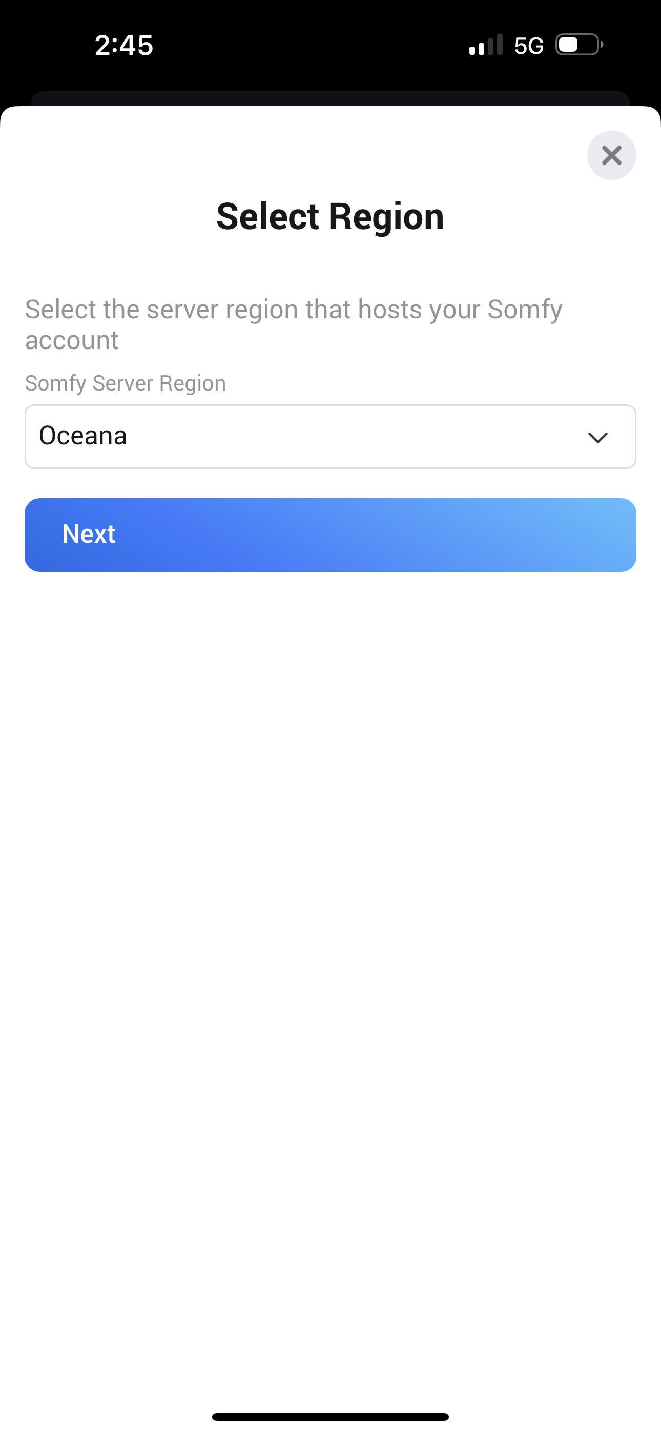

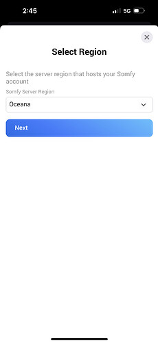

I have published a new test version that allows you to select the region. Can you give that a try?
Hi Adrian , do I just delete the app and re-download it to get the latest version or should it just update to the latest version when I go in. ? , I just checked this morning and it was the same when I went to login .
If you got to the app in the store and add /test to the end of the URL, you can then install it over the top of the existing app.
Hi Adrian, I got the app to install all ok I then went into add device ( RTS Blind ) and the next screen that appears is the region select , I selected ocean and it just stayed on the that screen and won’t change .
I then just left it for an hour or so and went back into try again it asked me to sign in and then all my devices were displayed I have now added all blinds and I am away from home at the moment so I will test there operation when I get back home and let you know .
