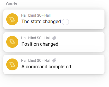

These possible WHEN-cards are on my Velux windows;
And these possible WHEN-cards are on my blinds;
