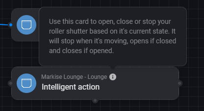

Hi all
Stop the movement - I would like to stop the movement of the awning while it is moving.
But this is not possible. How can I realise this?
This is from shelly and would be very cool…
There should be a card to set the state:
Just set that to idle to stop the current movement.
it only works if I execute the function twice…?
(it’s only a test here, doesn’t make any sense :crazy_face:)
If you use the device panel to move and stop, does it work then?
