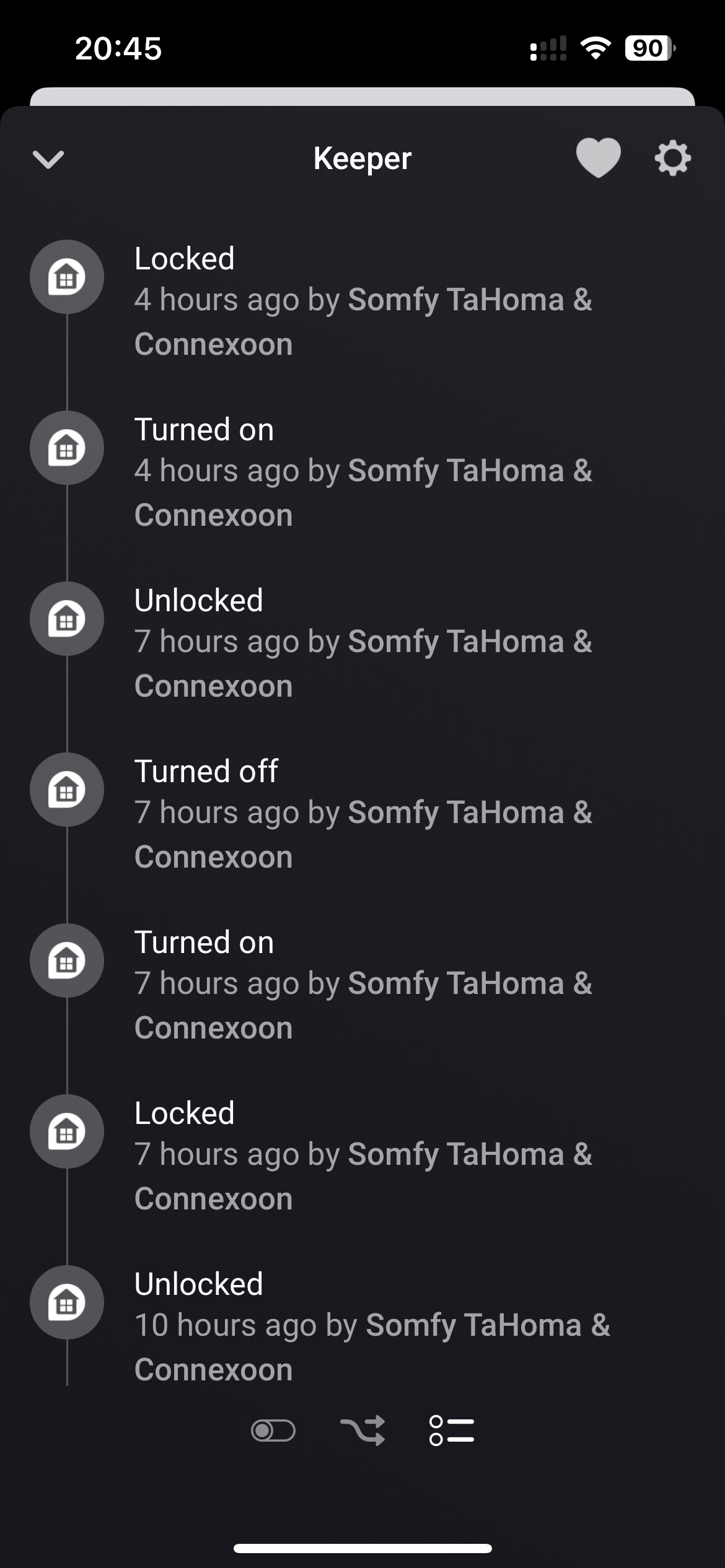

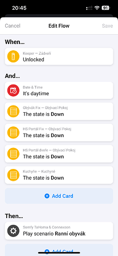

I’d like to have a flow that once I unlock my doors using Doorkeeper, then all blinds in a specific room will go to “My” position.
But it looks like Homey does not recognise Doorkeeper as unlocked when I unlock doors via keypad or nfc tag reader.

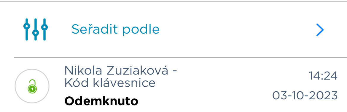

Attaching screens below for comparison between Homey timeline info and Somfy Keys info.
Any solution for that?
Thanks in advance.

I am also attaching an exact time when doorkeeper has been unlocked through keypad code, nevertheless homey do not recognise it and do not react.
