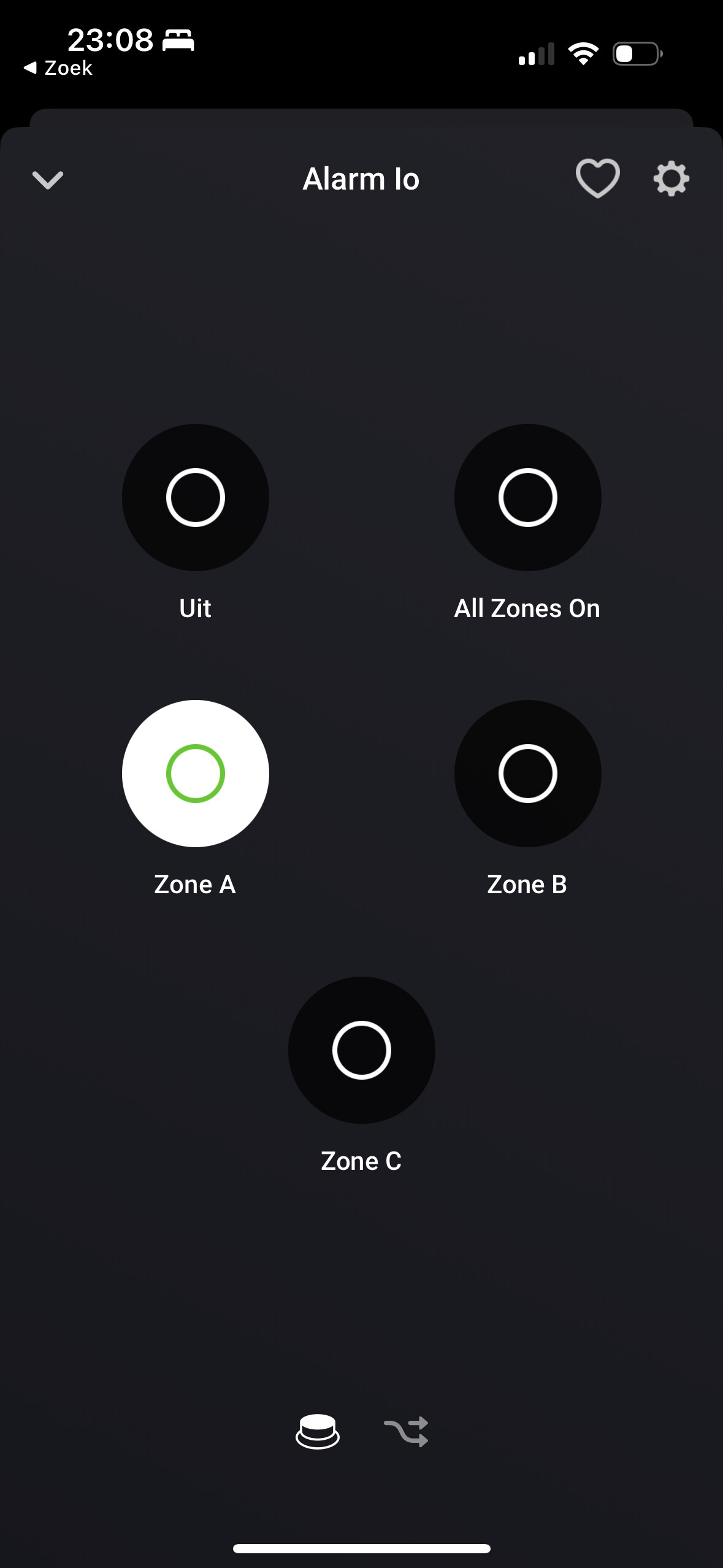

I don’t really understand the behaviour of the button colour (white/black).
When i open the device and press nothing i see the screenshot above as a atarting point.
When i press A then B then C and them A i get the screenshot below for a few seconds
It then after a few seconds jumps back to the screen below (same as first screen) and in this case zone A activated on the alarm.
I now by accident just discovered if i press A and then A again it activates zone A. Same for b and c. So pressing the zone button twice seems to do the trick!
I see no change om the buttons when the alarm is turned off. A, B and C remains white.
OK, I think I have found the issue so a new test version is up.
A white Zone button shows that the zone is set and a black zone button shows the zone is not set.
In theory, you should only be allowed to switch a zone on and the only way to switch them of is with the Off button. However, due to some quirks in the UI I can’t 100% block a button from switching off if you tap on it in quick succession. But tricking the UI like that doesn’t actually switch a zone off and at some point a status update will come in that puts the buttons back to the correct state.

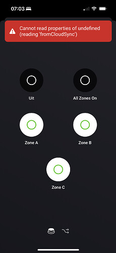

Pressing A works. However B and C generate the error as in screenshot.

When i press zone A - zone a is enabled
When i press uit (off) - all zones are disabled
When i press all zones on - all zones are enabled
When i press b or c nothing happens and i get the error as in previous screenshot.
When i press b or c nothing happens and i get the error as mentioned in earlier posts.
