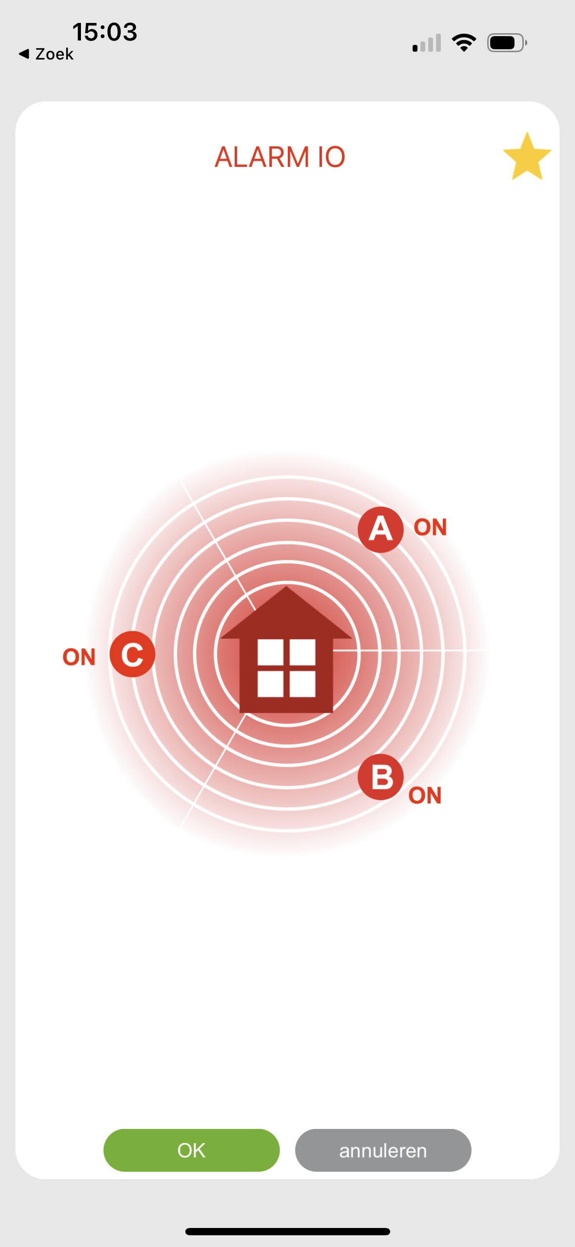

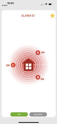

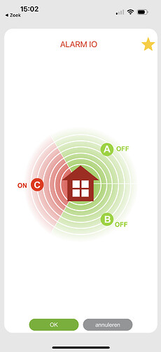

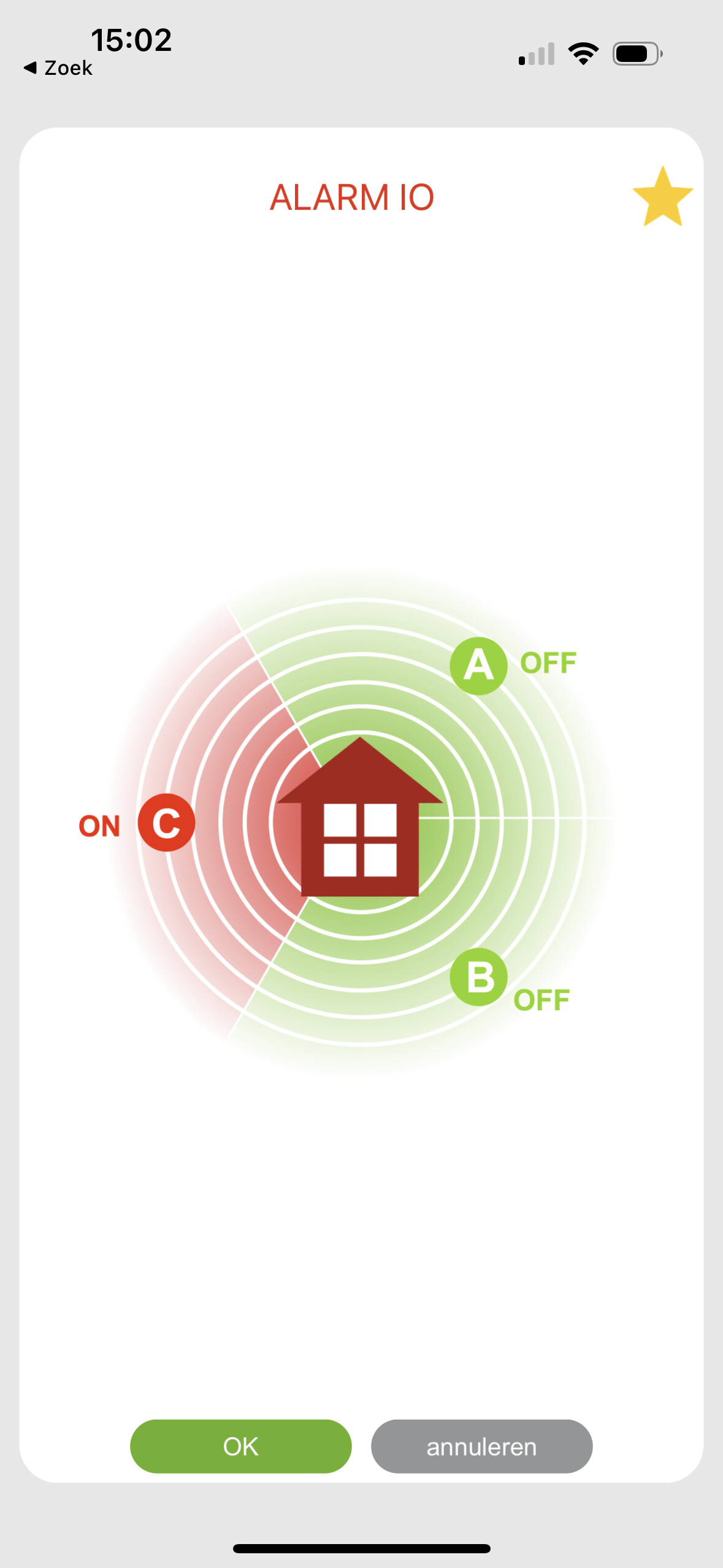

Hi Adrian,
The protexial io alarm is a seperate alarm from the tahoma box, but due to the io features the two connect. So can enable or disable zone or a,b,c or all via the tahoma interface. However the sensor triggers an alarm in the protexial io alarm system and not the tahoma interface. I use the tahoma box mostly to switch on or off my external protexial alarm system. My end goal is to have my loqed doorlock switch on or off the alarm system automatically when door is locked for the night or opened.
Attached below the screenshots from my tahoma box
Ps here the link to the manual of the protexial io: SOMFY PROTEXIAL INSTALLATION MANUAL Pdf Download | ManualsLib
If you have questions let me know
Ps Tahoma doens’t tell me if there is an alarm, the protexial io system does that via sms. I just arm and disarm the alarm via tahoma
Is there a sperate button to switch it off or do you just switch off all the zones?
OK, this is what it will look like:
So, you should be able to activate each individual zone with a shortcut to all zones and one button to turn of all zones.
I have just had a thought, if you had zone C on and then selected just zone A and B, does zone C turn off?
There is only a command to set the zone on “alarmZoneOn”, so I presume that if three separate commands are sent for “A”, then “B”, then “C” then all the zones will be active and the only way to turn them off is to send the “alarmOff” command.
I will work on that assumption for now and release a test version so you can try it and let me know.
You can switch on zone A B C seperatly and switch them of seperatly. One doens’t affect the other
 if that is what you mean. I assume the full enabled alarm switches on abc simultaneously and switches of abc simultaneously
Thank you!
There is indeed a seperate button to switch all off or on. It is the house icon in the middle
 green off and red on
This looks fine!
