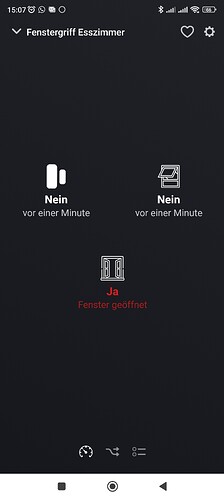

I noticed that since one of the last test versions, the “window open” status is also set if the window is only “tilted”. this was not the case in the older versions.

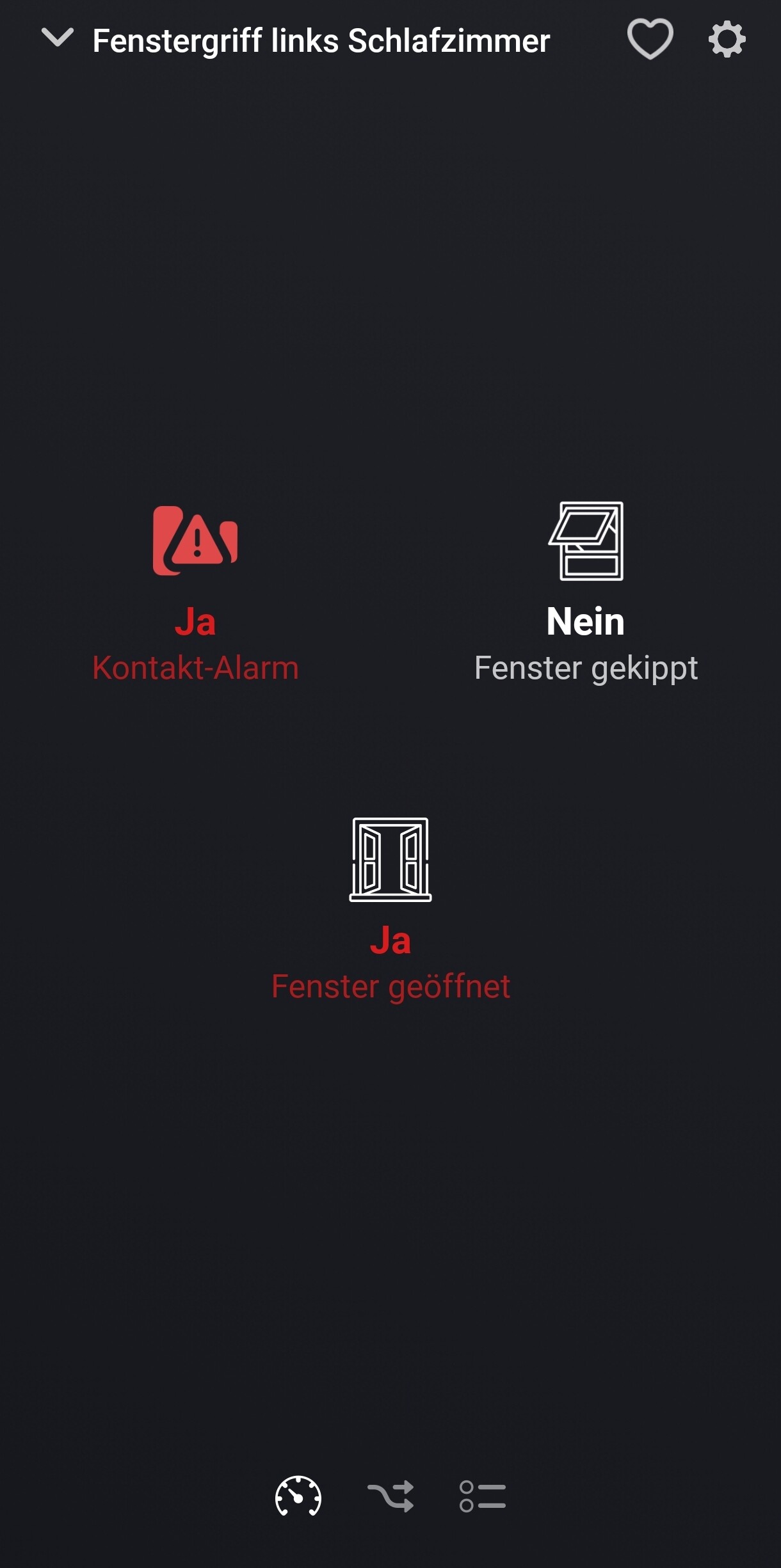

HI @Adrian_Rockall
Unfortunately the bug still exists.
If the window is tilted, then the status should only be “tilted” and not “tilted” and “open”:
If the window is open, then the status is correct:
If there’s a way you can fix this, that would be awesome.
Thank you
I thought I had fixed that so I will go back and check later today.
I presume you are using the latest test version?
Yes i´m using v4.0.56 test-version.
I have just published a new test version. Can you try that to see if it fixes the issue.
Hi @Adrian_Rockall
Unfortunately it doesn’t work yet.
Now the status for “window open” doesn’t change anymore. it stays on “open”.
Thanks
Ok, another test version. I forgot that the state is processed in two places.
Unfortunately, the window status “open” is not reset even if the window is closed
Thanks
Another test version. I think I need to get more sleep as I’m missing silly things, so sorry for going around in circles.
now it works perfectly. thanks for the quick fix.
