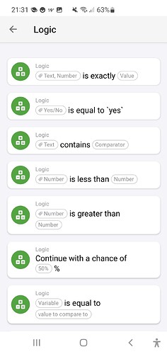

You can use tags in the logic cards.
I must be thinking wrong then, cause this setup of cards does not work for me. Even if the position is fully extended - 100% this flow always sets the position to 35%
What am I doing wrong?
EDIT: I included a flow card with a message to myself with the value of the ā€œpositionā€ and it reads 1% regardless of the position of the awning. I tested it in both fully extended and 70% - the tag returns with 1% value each time.

The value of Position in a tag is in the range 0 to 1, so 35% will be 0.35. This is the way Homey works internally so I have no control over that.
No problem! Then I know, thank you very much :+1::metal:
