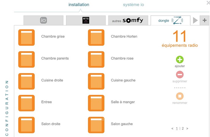

I wonder if it is possible to use rolling shutters using the ZIGBEE protocol on your application.
The rolling shutters are from the PROFALUX brand. I use TAHOMA V2 box.
Thank you for your response.
Your English is fine.
If the shutters are in Tahoma then I can make them available in Homey.
Could you send me the device log from the Configure App screen so I can see what they are reported as and what capabilities are available.

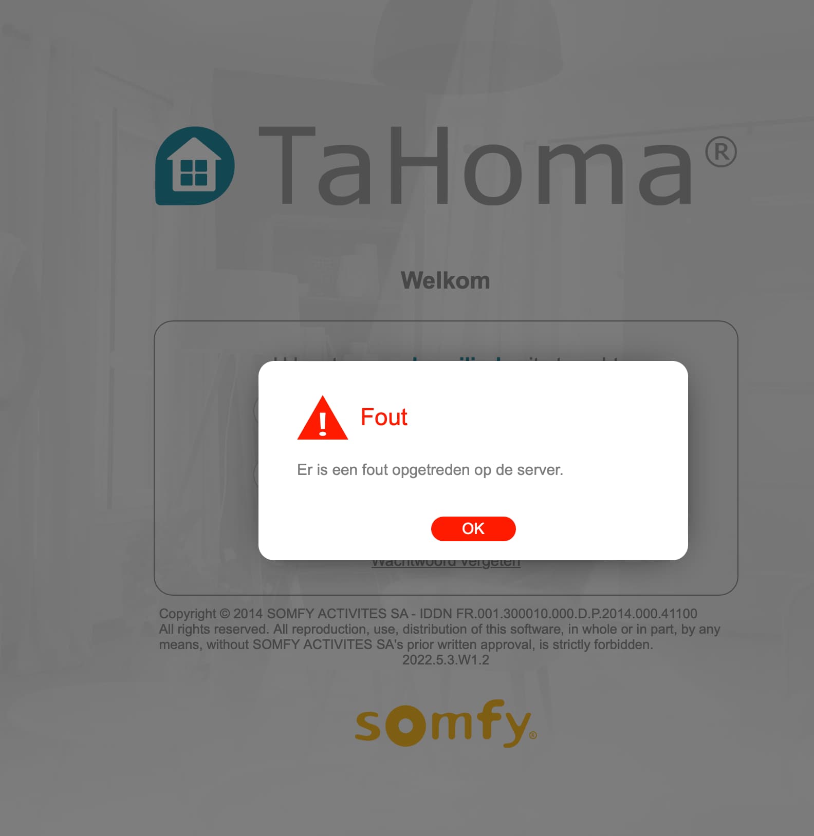

having a hard time to get to my account from https://www.tahomalink.com coldfusion errors.
is there some direct link to set local api?
got it though somfy.nl and go to my box.
Unfortunately still can’t seem to login. Not the 401 problem anymore, but just an error.
Got the connectivity box, and think I am nog able to get into developer mode unfortunately.
Could you translate the message for me?
