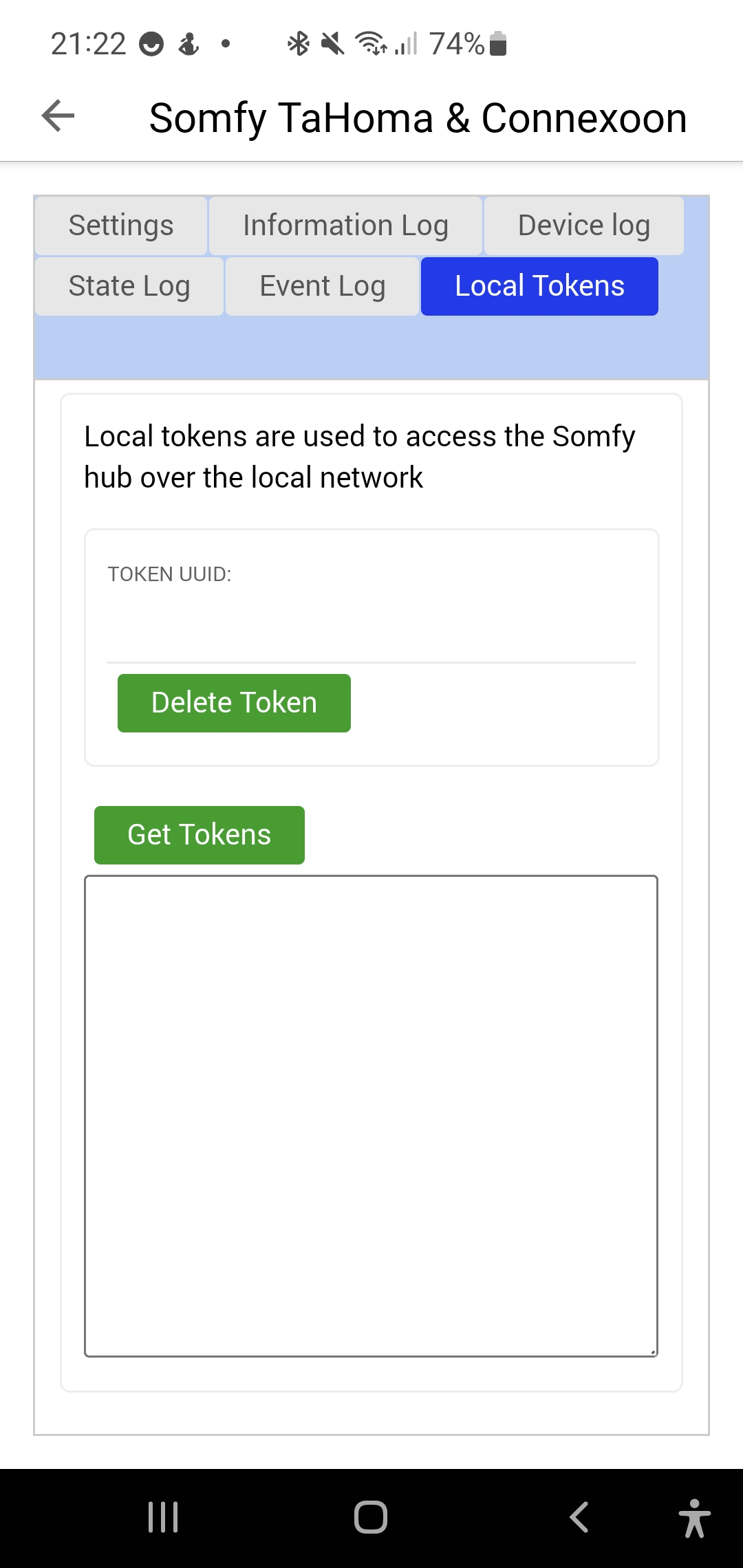

But I can’t figure it out how to get the local api going. Where to find this code. On my computer in the somfy account i turned on the “modus for developers.” But don’t know how to get the code. Maybe this is so easy, but i can’t find it.
Could you guide me?
Thank you very much.
The app will automatically get the code once the developer mode is enabled. It will use your account login details used for the cloud to get it.
If you go to the Configure App page you can use the Local Tokens tab to see if it has got a token.
Tap on the Get Tokens button to see it. Note. all that is doing is fetching the Tokens that have been registered.
Thanks again Adrian. Got it. But must i fill in the token uuid?
It is now saying “can’t read properties of null” when i want to close the blinds. I think i done something wrong. It is saying it is in devmode if i get the token and a uuid code.
It is also saying in the log wrong cert cn for
--****.local
I sended you a log file.
You only need to fill that in if you want to delete a token.
Could you try restarting the app to see if that helps?
As the local connection is using https, Somfy provides a certificate that’s used by app when communicating locally. For some reason that’s not working but I’m not sure if it’s an issue with the certificate or because the app started before the Developer mode was enabled.

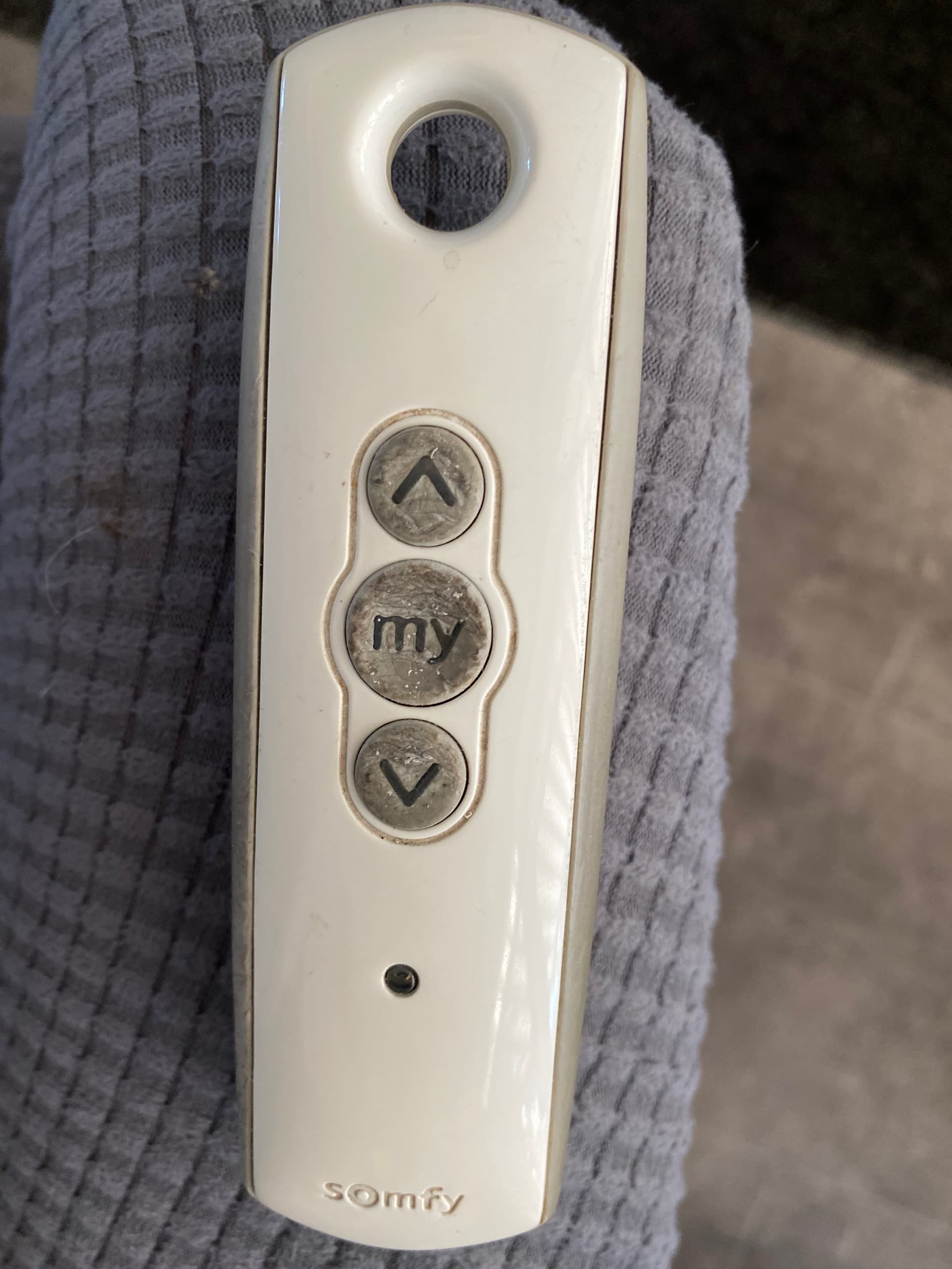

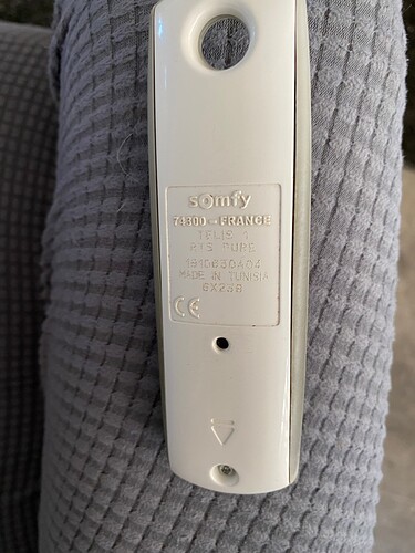

@Adrian_Rockall can I add my rts remote blinds with this app have this remote
