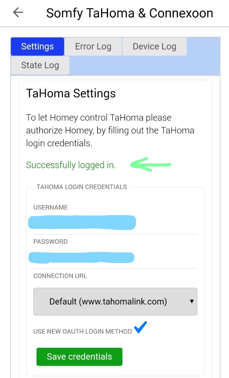

Could you check the settings in the Apps - Configure app page as I have been adding new login options to try and help users that could not login before for the same reason.
Make sure to start with the default server and ‘USE NEW OAUTH LOGIN METHOD’ not ticked. If that still doesn’t work then try ticking the new login method.

Is the login working (green message saying successful), after you save credentials
Yes
Did send an errorlog
