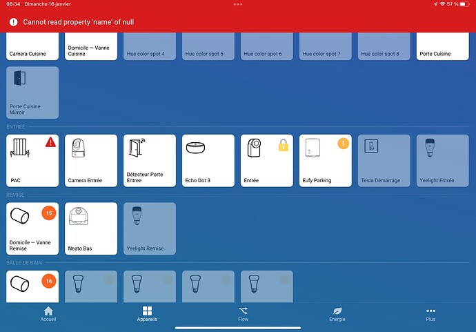

1- I changed to new ID and password, that did not help…still refusing to connect to any server. Well that was until start of 2022 where now I can connect the connexoon fine to the homey app using the initial id pwd. Problem solved, then ? Nope coz the homey app cannot find the heat pump once paired with the connexoon and initial credentials.
So Problem 1 remains.
2- in between I tried the Tahoma light aka « connectivity kit » because it is much cheaper than a Tahoma Switch. Well, it does not manage my Atlantic heat pump. So end of story. Just for the record.
3- then I bought a Tahoma Switch that does manage the heat pump. Everything works fine with a different ID password than the connexoon. Homey app finds the pump, it is responsive to Homey commands… But after a couple of hours I have an alert in Homey on the pump.
It becomes irresponsive. I tried the auto repair invite. To no avail. Just runs its operation and comes back to starting point.
Problem 2 rises !
=> any thought would be appreciated, I have the feeling that I am close to finalise the heating function in my home. Hopefully before winter ends :slight_smile:
Thanks a lot for your dedication !
Could you enable the Information log (blue tick) then wait for the error to occur and then send me the log.
Hello Adrian,
I reinstalled the pump after I suppressed it so you to have the full sequence.
I just sent the information log.
Thank you again.
