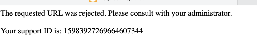

I can’t login anymore, although i can on the Somfy website with the same credentials…
But i get a strange message on the website, "Requested Url was rejected, see photo) but after a few seconds it works…
i have send you a log.
Could you contact Somfy about the web login as it could be related if there is an issue with your Somfy account.
Also, try disabling the app for about 30 minutes. Maybe the continuous failed logins is prolonging the issue.

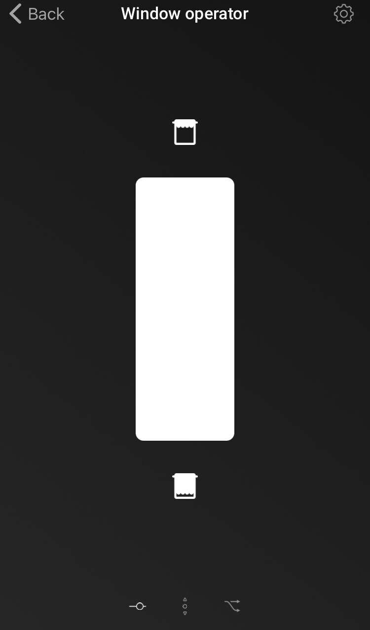

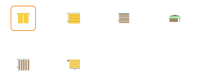

My Velux roof window is somehow interpreted as a curtain and not a window. Is this a known issue?
If you mean the type of control that is presented then then that is all Homey has for position information.
Alright, thanks for the reply. My issue is actually with HomeKit where it shows the window as a curtain, when I would expect it to show up as a window. I’m using Homeykit - any idea what could cause this?
Ah OK, Homey doesn’t understand windows.
Here is a list of classes, which are the types of devices:
https://developer.athom.com/docs/apps-reference
So I’m not sure how HomeyKit can report them as Windows. If anyone knows what class would work then let me know.
