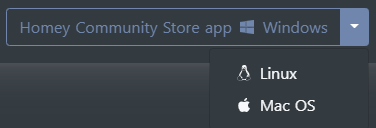

You only have to install the Homey Community Store app (for Homey) once , with a Windows, Linux or Mac OS machine:
Once installed, then all the apps in the community store can be installed by phone as well, just like the Homey app store.

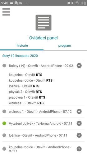

And I have one questions I have at home more types of somfy rolets and one of them it can not be find in Homey app, is it the problem because they are little bit older, what could be the problem? thank you
It might have a different product identification in the data. If you get the device log and send it to me then let me know the name that you have given it I will try to add it in.
Hello Adrian, I get these history log, is it what you want?
I have about 19 inside RTS blinds and 2 io outdoor blinds and one pergola also io.
Outdoors blinds and pergola (io) work well I get them in homey but the RTS I cant get into homey. All blinds are connected to TaHoma and I do not have any remote control, I just use my phone (somfy tahoma app)
Thank yor for your help
RTS somfy pic1
