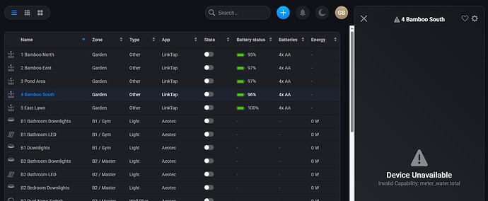

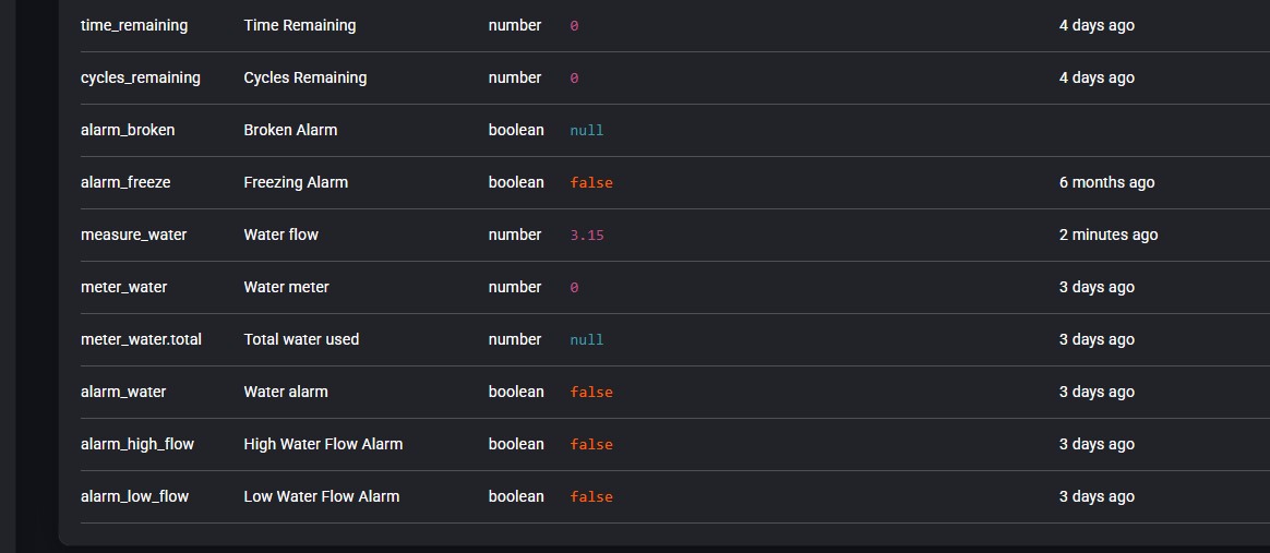

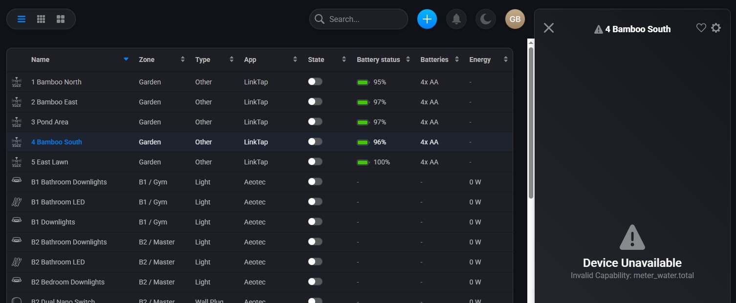

Hi @Adrian_Rockall It seems there has not been much activity here for a while…I’m just wondering if this app development is still in progress? I am having a couple of issues which look to be experienced by other users also, from a review of the GitHub notes.
The two issues are:
  1. the ‘red exclamation mark’ appears on my link tap icons in HomeyPro when on the mobile phone version, and they need to be ‘reconnected’ before being able to use any functions or flows.
  2. There is appears to be an issue with a variable “meter_water.total” as it shows “Invalid Capability”.
I think both of these issues are noted by other users on Git, so it’s almost certainly not my specific set up here. Fyi I have a HomeyPro 2023 plus 4 port linktap, and a single port linktap.
See some screen grabs attached, and please let me know what I can do to provide further data / logs to hopefully progress and resolve this issue…?
@DirkG I note you’ve been a contributor on this app; any thoughts on this one?
Note that I’m pretty confident that my connection strength to the garden unit is good, as I’ve reviewed the linktap webpage showing such data and it’s pretty strong, well within their recommendations. The re-connection process works perfectly every time it is manually used, but after some number of hours - 5-6 or more I think, although I haven’t tested this explicitly - it just seems to fail again.
Any help greatly appreciated, as I’d really love to be able to use Homey flows to drive my logic for watering, even though the LinkTap mobile app functionality is really good…
Cheers, Graham.
PS: Minor update to the above, I tried to find the LinkTap devices in the Homey Dev tools, but they are not shown under Zigbee, per screen shot, only a couple of zigbee RGBW lights I have are listed; is this correct? Seems a bit odd, but I can see them under the ‘Devices’ section at least…
