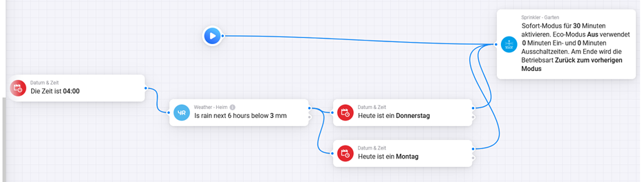

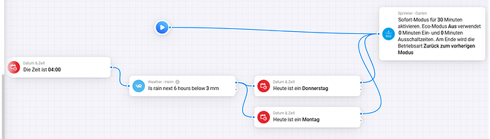

Hi all,
Homey Pro 2023
I have have a time issue. My flow is very simple.
When: Its 6:00 in the morning
And: Is rain next 6 hours below 3mm
And: Its Monday or Thursday
Then: Sofort-Modus for 30 minutes
But it starts not at 6:00, it starts at 7:00 (one hour later)!
I checked the time in Homey, is correct.
I checked the time in the Linktap iOS App, is correct.
Is it possible that the fault could be in the Linktap homey App or is the fault in homey self?
In my view, its homeys time wich starts the flow, so its on homeys side, correct?
I would say it’s in Homey as the app will send the command immediately the flow tells it to.
Hi @Asterix
I would say it’s on Homey’s side, because it’s the default time trigger card.
If time is correct in Homey, the time zone should be correct, too.
Do you have an HP23? Perhaps it’s again a firmware bug.
Thanks for answering.
Yes, i have a HP23.
So i will report it at athom
Have a nice day…
