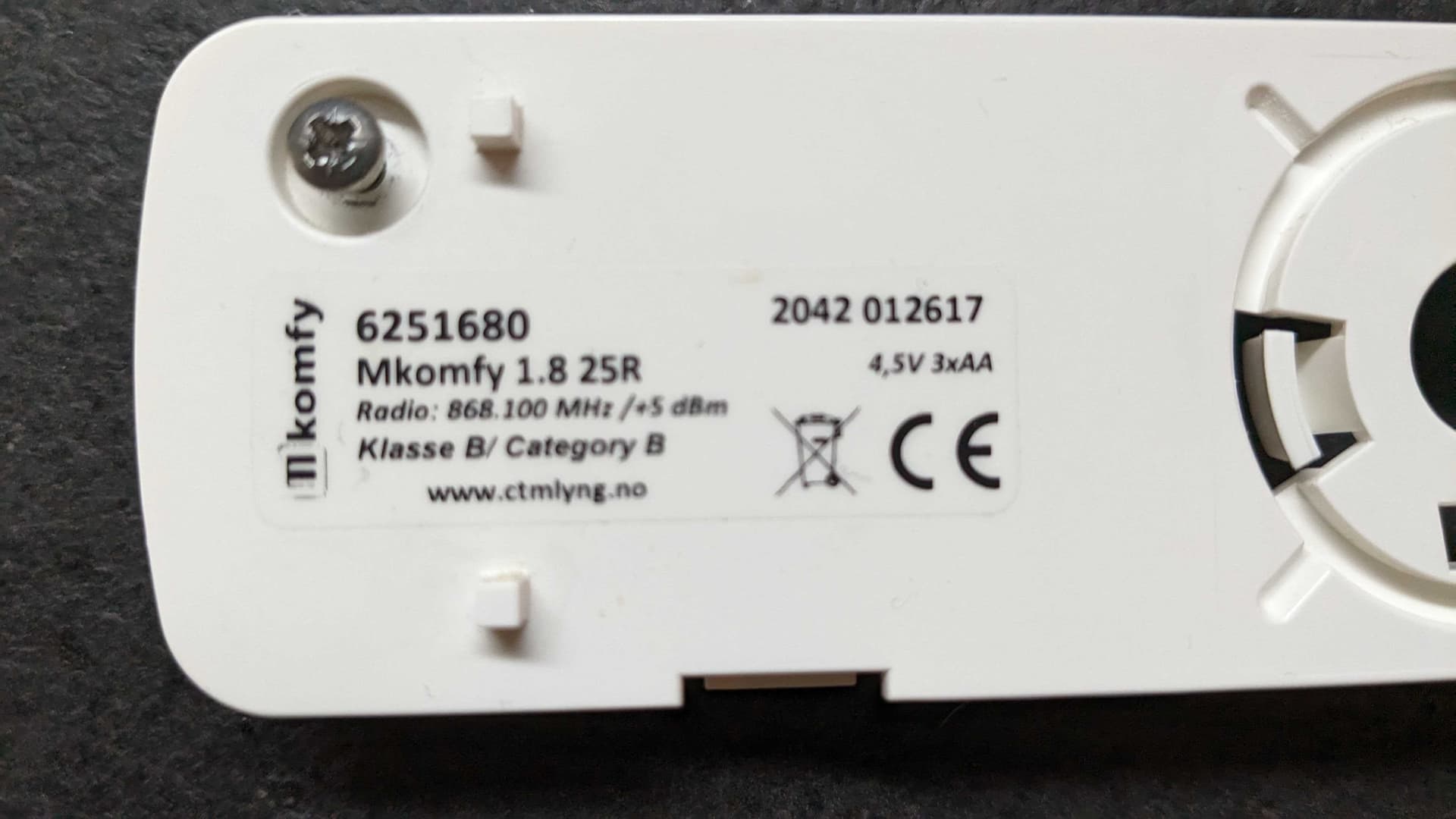

Will this device work? I dont have this button inside the sensor cover.
No, this sensor is to old and do not have the zigbee radio.
Ok, thanks for info :+1:

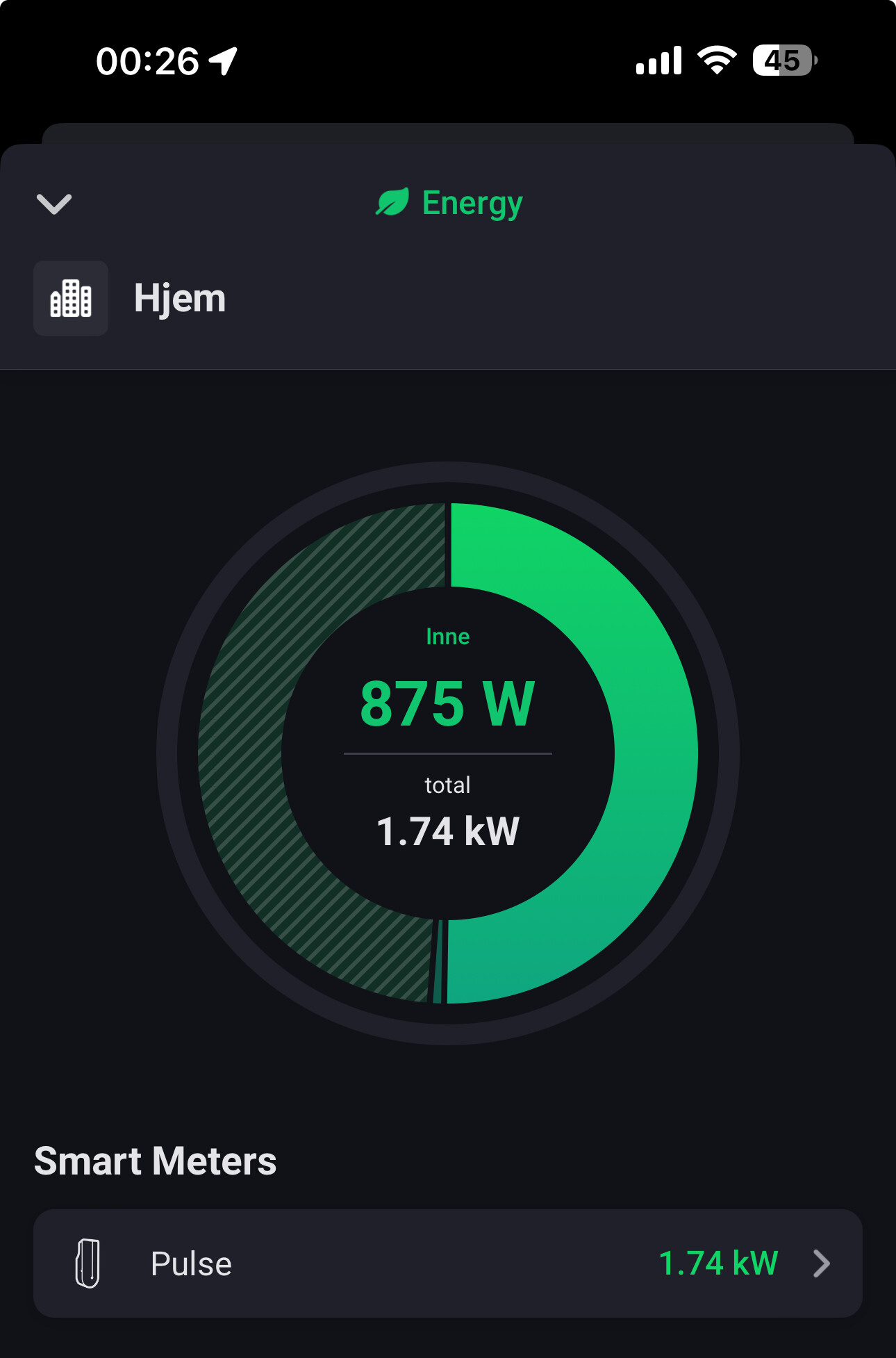

Is it possible to get the mTouch One to show the energy consumption here?
I am using it in regulator mode, so seeing the set temperature as the status indicator is not really helpful for me.
And is it possible to get it to report the actual energy consumption to Homey, instead of the average?
Example:
The actual consumption is 1kW, but the regulator reports itself as using 480W, which makes the energy diagram in Homey app be inaccurate.
But the regulator only reports as using 480W because that is the average, so it makes it appear as if something else is using the 520W difference.

I don’t think it’s possible. Since it’s a thermostat, Homey determines what can be displayed in the icon. It works on the web-app
I’m working on a version that calculates the power based on the status of the relay, not the average that the thermostat reports. I will let you know when it’s ready for testing

v1.1.14 er now ready for testing :slight_smile:
Tested, and it seems to work :slight_smile:
Both my thermostats now report the actual power to Homey
