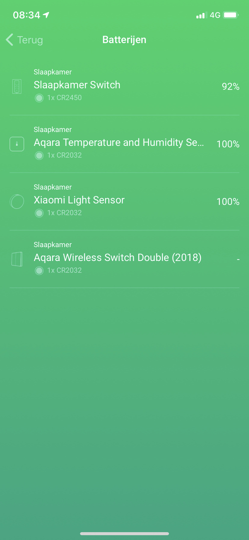

Today I received my wireless double switch. Adding was easy and it works great with the single press etc.
But my switch doesn’t get a battery status. Homey also think it is using power. Is it a familiar problem or am I doing something wrong?

I use the wireless switch directly on homey with te aqara app. Not using hubs at all.

The homey version is 4.2.0. But there are no updates available. Is there a other way to update to 5. Automatically update is turned on.
The switch is working fine. Only the battery status isn’t. See the picture (the language is Dutch)
It is said: device isn’t able to operate.
