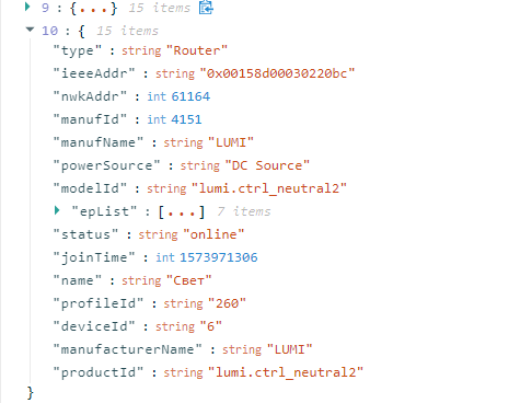

Does anybody use wall switch no neutral (lumi.ctrl_neutral1,2) without any problem? As i saw in the web they are works good only with gateway.
I use it for over month now and not a single issue.
What switch’s version do you use? When you buy them?
Can you show me what is in the zigbee page
My device: image
Here you go:
15
