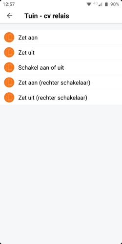

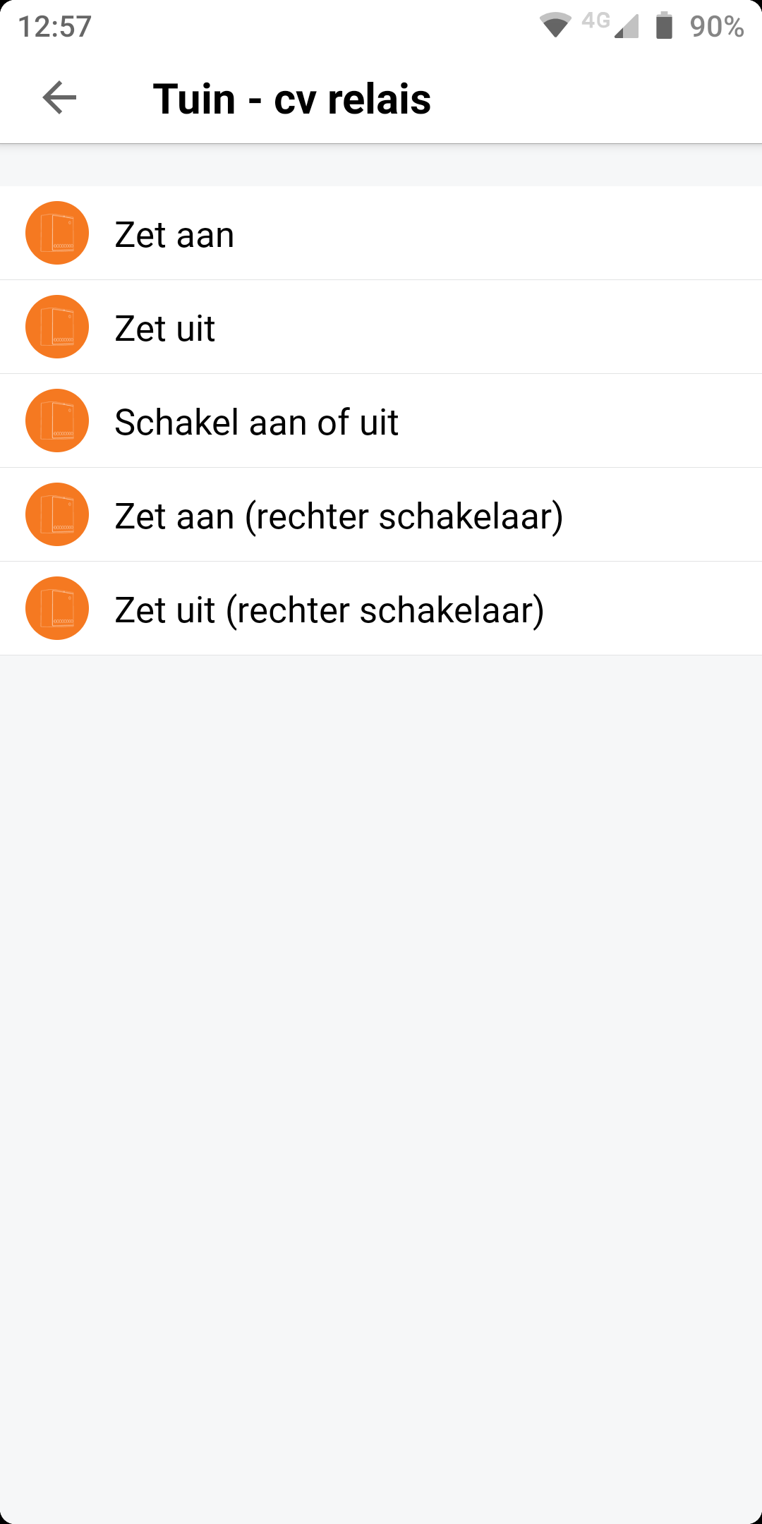

I have included mine, and it shows as one device.
That devise has the following flow actions:
Sorry for asking this, where to find the second switch?
I only have 1 device and the flow options do not show Left / Right or Switch 1 and Switch 2. If I open the device in the Android App, I do see ‘switch 1’ and ‘switch 2’ available in settings.
One flow with in THEN the “Zet uit” (read for the left switch) & “Zet uit (rechter schakelaar)” action cards?
Thanks for answering while I was still correcting my spelling :wink:
In the THEN section the relay only shows these options:
So, only 1 option to OFF the relay. Not two (L and R)
