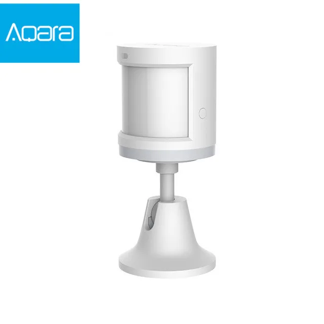

I have the Aqara motion sensor as in this link (not for this insane price. but for example)
And made a flow to turn on my HUE lights.
It works. The motion is detected. And the lights go on.
I have set in the config. The motionsensor should "refresh after 60 seconds. And my lights dim after 120 seconds.
But the sensor keeps on giving a motion detected and will not refresh after 60 seconds. but maybe after a minute or 4. sometimes 6 minutes. Not a steady value.
So if i am still in the same room. The lights dim after 2 minutes. And the sensor does not pick up a new movement. so i am in the dark. Until the motion alarm is off. after several minutes. And then detects a movement again. and turn on the lights.
So no steady refresh after 60 seconds. Am i doing something wrong?
Did you set the ‘reset alarm after’ setting at the correct value? Please show us the flow you’ve made.
As i assume, most movement sensors have a value for “blindness” (the time all movements will be ignored after the first movement) and a value for “reset” (put the the alarm state to “false” after movement). In your case, the second one is the most important and should be set to a desired value. But if the blind time exceeds that value, still no movement will be registered.
i encountered this as well…
Min value for this parameter is 90 sec.
Thank you guys for the respons. first i had a flow to put on the lights. And in the same “then” side. I had a command to turn of the lights with a 60 seconds delay.
With that config i had problems.
Now i have a sepered flow for turning of the lights. With a countdown counter. of 60 seconds. And this is working like a charm. So i think all is good now.
Tnx !!
Yeah untill you stay in that area for longer than 60sec :wink:
Why don’t create a flow which turns on the lights if there is movement, and another flow which turns it off when the motion sensor doesn’t see movement any more? (depending on the refresh rate of the sensor)
You can even have it turned on only if lux is beneath a certain value :wink:
