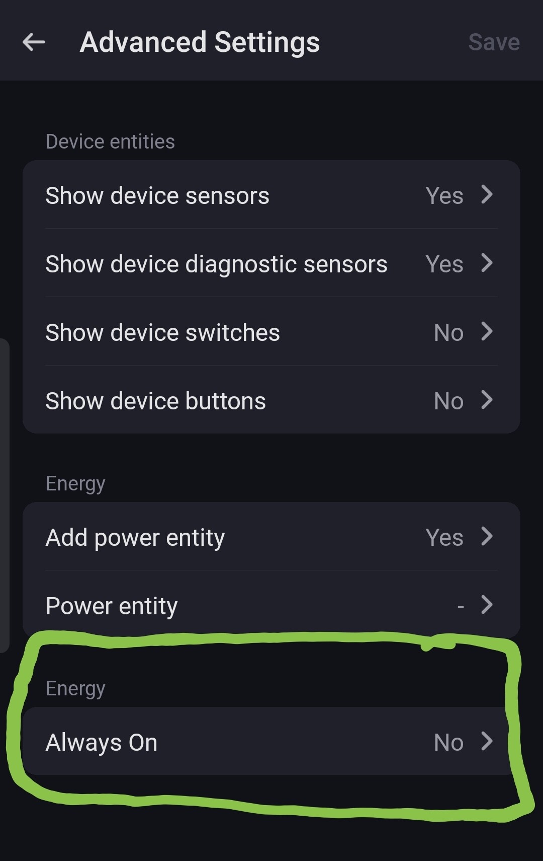

I have two Aqara Smart Plugs connected to my Homey Pro.
One of them has this behaviour:
  • In the Homey App I can turn the switch on and off
  • The button on the plug does nothing (except make the blue light flash)
    (sometimes after unplugging it, it works briefly)
I have tried restarting the Aqara app.
The other Aqara plug’s button works well.
Looks like Aqara is having a tiny quality issue, isn’t it?
What made you conclude that? There is really no information in the whole post that points that way. In fact, it is just a description of what is happening without any further useful information.
Yes it could be a Monday morning device, but,
most probably it’s disabled, and it is set to “always on”, or “child lock”, something like that.
Go to device settings by longpressing the device tile @ mobile app, and go to ‘Advanced settings’, something like:
Or:
So, you’d only have compare settings of a “OK” plug, and the plug with the numb button and spot the deviation :wink:
