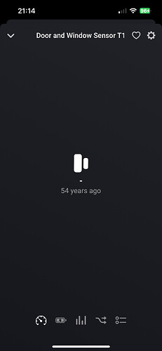

My aqara t1 door sensors do not work. Contact alarm not showing any status. I can add the sensors without problem. Tried several times and different brand new sensors. Using version 10.0.8 on my homey and latest version in aqara

If so, please try to remove the sensor from Homey and re-add it to Homey. After re-adding check if the device starts reporting (instantly). If not, please share a app diagnotics report (again), but before sending this report, please send a Homey diagnostics report (app > settings > general > Create diagnotics report) first and mention this 8 digit number in the text of the Aqara app diagnotics report. Then I will ask Athom to look into these reports to see what is going wrong.
Ah sorry, forgot to include my name. I’ve tried again but unfortunately the same issue.
Added without problem, but unknown value in contact alarm and a question mark for the battery status.

Just to confirm, you opened and closed the contacts a few times after including the device and before submitting the reports?
Yes :slight_smile:

Try add the device then remove and insert the battery! I had the same issue with a aqara temp/humid sensor t1 that I bought today. Homey 2019 with latest firmware and app version. It added fine, but no data reported. Tried probably 5 times, same issue. Then removed battery and inserted and now it seems to report fine, ive had a couple of data updates in the last 15 minutes.

I installed the test version. I still can’t access my Aqara door and window sensor T1…
Can I provide you with more information besides the information [Johan_Mauritzson] gave you?
