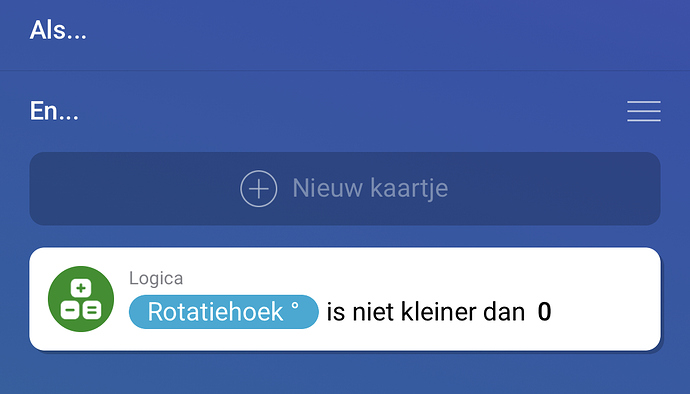

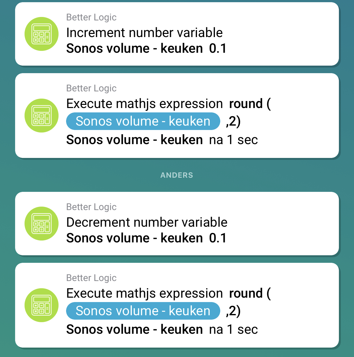

Can somebody share their flow with the new 2.0 app if they managed to get the volume up / down of a sonos system by turning the cube clockwise / anti-clockwise? I can not figure out how to make it happen…Thanks in advance.
@Mole did you try a similar setup as described in:
Yes, but can not see where I go wrong:
Step by step:
  1. I would recommend to combine both actions into one into the math.js calculation card
  2. does the first flow work? Manually set the volume of the Sonos to a different level and test this flow to see if the volume is changed
  3. Does after a rotation the BL variable change?
Don"t see a command to actually SET the value (Sonos volume - keuken) to the Sonos speaker.
if you don’t SET these value to the speaker, it won’t work!
Forgive me for being a noob. I tried several options but it does not respond. When i test the first flow it gives me an error: Token_out-of-range. So the answer on the 2 question is no. I do not get the first question, where and how can i combine both actions?

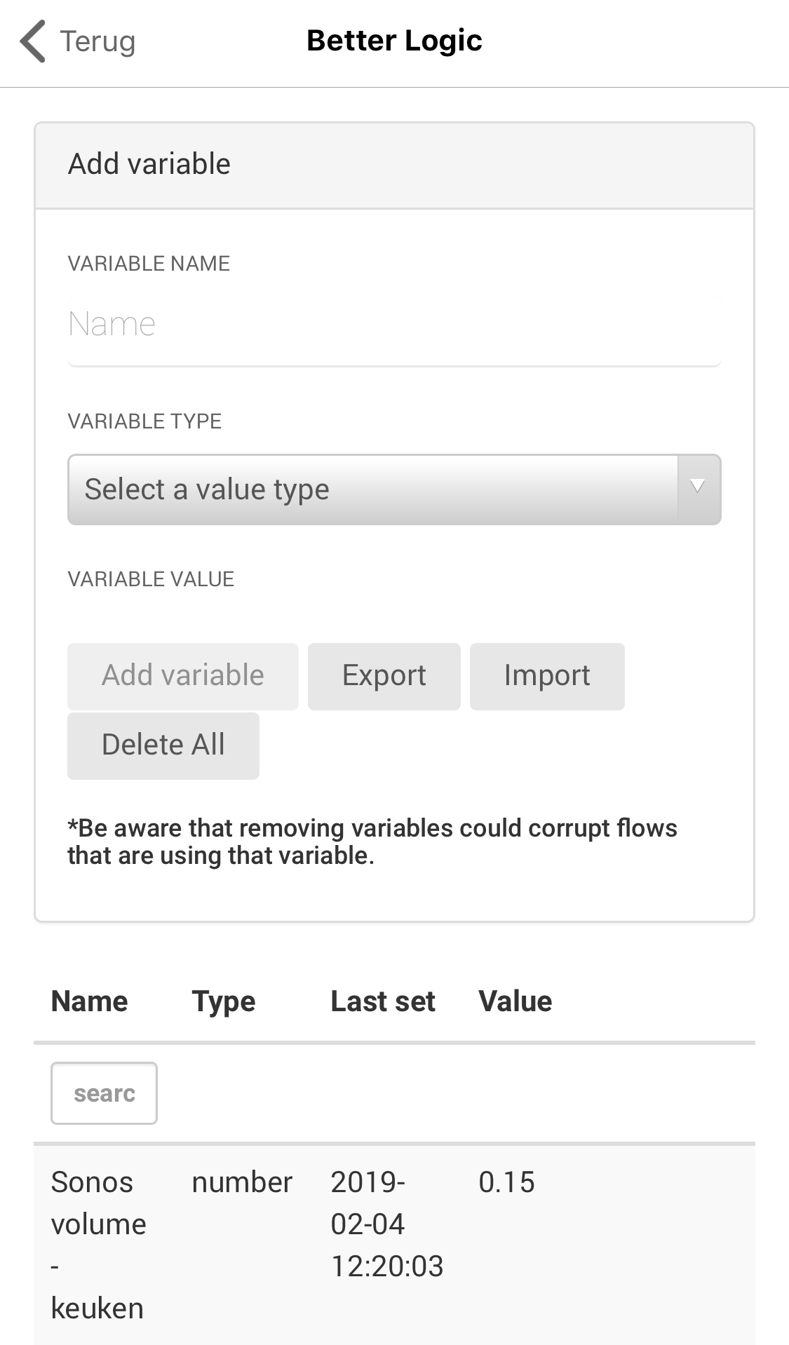

About the third question, if i turn the cube i see that the variable does change…
I made a ā€œsimpleā€ flow to see if it works anyway, and in this setup it responds. It seems to go wrong with translating the turning into a volume step.
Can u try the BL cards without the tags but with the names of the variables typed?

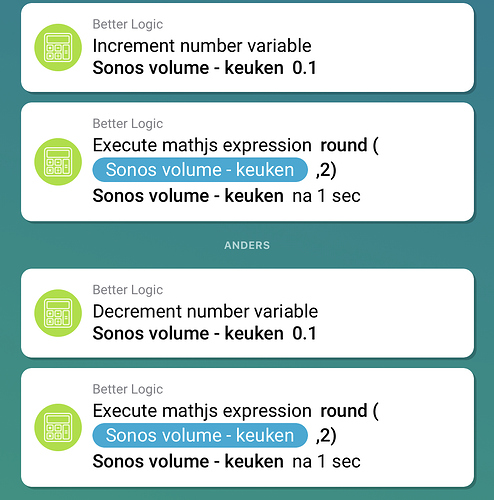

If you mean like this, then unfortunately IT does not work…
Your variable ā€œSonos volume - keukenā€ is now updated, but you need to set the value of this variable, to your Speaker by adding an extra card like:
image Sonos volume - keuken
Hi JPe4619, i have that already in another flow:
This with the flow above is the setup in wich i try to make IT work (+the BL)
