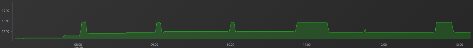

Hi Jeroen, I have the same strange behaviour in my wine cooler:
It goes up to 17,89 degrees almost every hour, while the cooler is completely off (the fridge is controled by Homey).
I use the Xiaomi Temp en Humidity sensor, the square one…

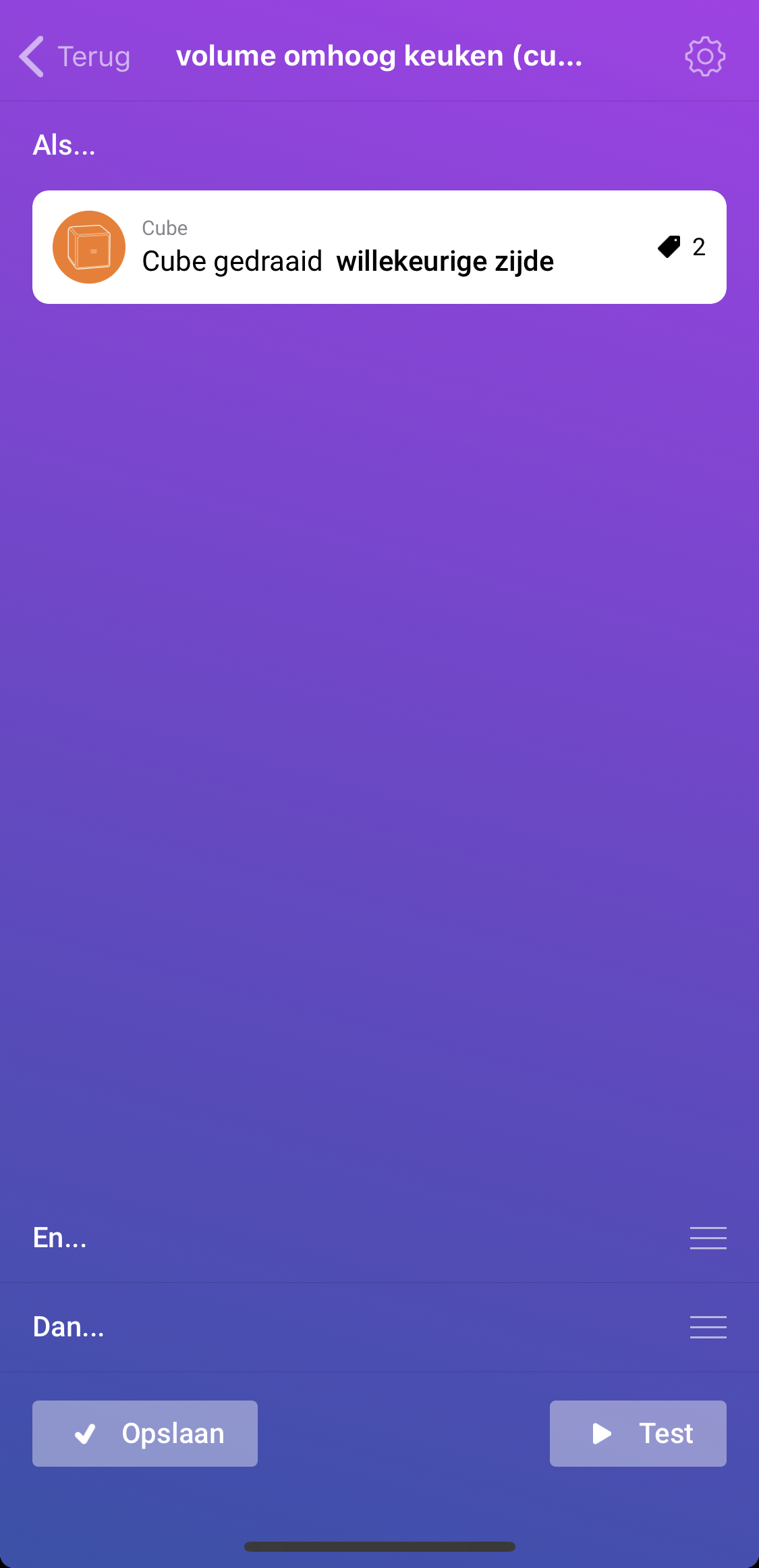

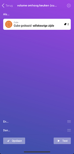

Since the update to 2.0 my volume turning on the cube does not work anymore.
Can somebody share their flow with the new 2.0 app if they managed to get the volume up / down of a sonos system by turning the cube clockwise / anti-clockwise? I can not figure out how to make it happen…Thanks in advance.

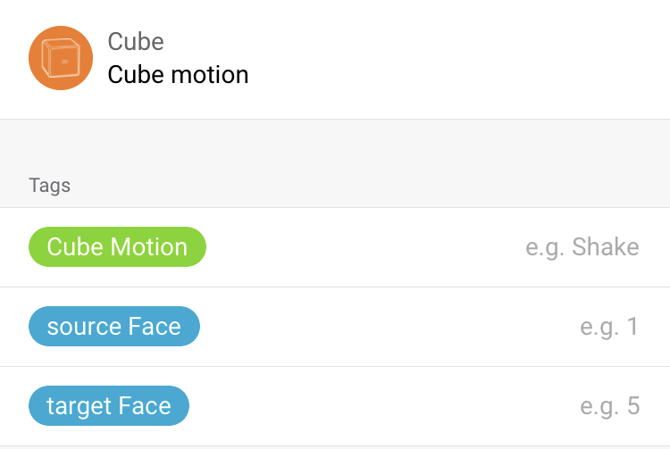

In the Homey v1 it was in the tags possible to which side was up. In Homey v2 i don’t see this option anymore.

The face side is part of the arguments of the flow card: press “Any side up” and you’ll get all available options:
The alternative option is to use the “Cube motion” card:
Which will add the local tags “source face” and “target face”
Final alternative is to use any of the trigger cards (with any side up option where applicable) and use a build in logic condition card with the “face up” capability tag:

I’ve just uploaded v0.5.1 to the app store (waiting for approval); that should solve the issue with incorrect temperatures being reported
