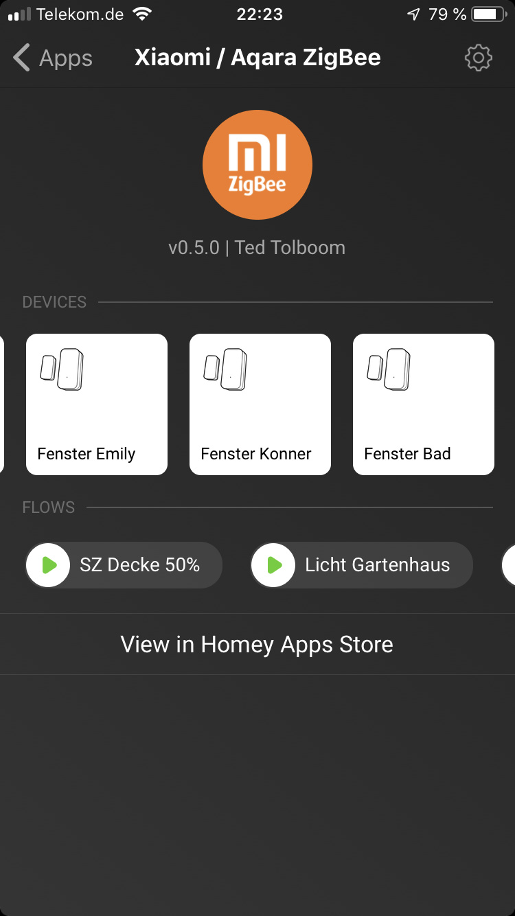

Hey @TedTolboom, i cannot See the battery levels of my doorsensors or tempsensors. Do i habe to ptp? I have the 0.5.0 app version.
I had some sensors without battery status also, remove and reinclude resulted in battery info for those sensors.
Ok. Thx. I will see if I will do this. It is not do important for me.
@PhilS I can’t see based on the screenshot shared, if it is the Aqara door / window sensor that is reporting the battery levels or the Xiaomi door / window sensor (that is not reporting battery levels).
For a full list of supported devices and their capabilities, please see this topics opening post / or the readme on Github
Sorry ted, it is the aqara (not the rounded older one)
Or am I wrong? Could be, then sorry
I will readd them if I have time. No problem. Keep up the good work @TedTolboom
In that case, you included them already to Homey before I added the battery capability (~March 2018)…
In that case, you’ll need to follow the advice of @Erik_de_Vries to remove and reinclude the devices to add the battery capabilities.
Yes that was long before march 18 indeed. Ok i will. Thanks
