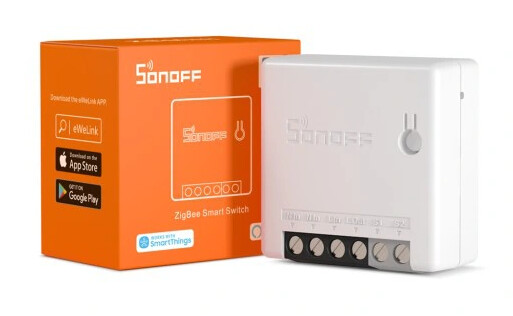

The battery is new in the device. I even tried another device but same result. The device is about 2-3 meters from the three sonnof controllers that are working correctly. I paired everything directly at the point of use. On the picture below is the sonoff Smart switch i use…
This sounds like either a defective device, or a specific combination of devices that just isn’t working well.
In any case, if a Zigbee device stops being updated in Homey, it’s always an issue with the underlying Zigbee core and not the app itself. The app receives signals from the Zigbee core (“hey, device X sent message Y”) and if the core stops sending those messages for whatever reason, there’s nothing the app can do about it :frowning:
I thing, it has to be combination of this two devices. Sonoff x Aquara… Exist anny possibility to tel to Aquara: “Hey, you have to connect directly to the Homey Pro! Dont be stupid, and dont connect to another device!!!” ? :slight_smile:
Next episode is, the device nr.1 is connected to HP with the same sonoff device (Another one), and is working correctly…
It’s not possible to tell the device to pair with Homey directly, although you can try to pair it right next to Homey and hope that it will use it.
