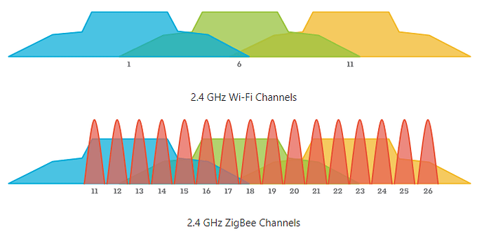

Sounds like an interference problem, is your wifi on the same channel as zigbee?
Thanks Glenn. I checked and initially I thought they overlapped (both on 11), but then found an article explaining this interference in depth:
and it was posted before (I just saw). There is a nice graph visualising this overlap. Just posting it here for anyone else experiencing the same.
So, my WiFi mesh was on channel 4, which might interfere with Zigbee channel 11. I changed that and will now await if this improves over time.
