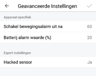

I’ve modified two Aqara motion sensors to make them “Hacked sensors”, but I am still not able to set the blind time lower than 60 seconds in the app.
The text hint says that I should be able to, so what could cause this?

Yes. But I am still not allowed to change the value down from 60 seconds (topmost value in your screenshot). Input box just gets a red frame around it, and I can’t save.
You don’t have to change this value.
After you’ve selected “yes” at the “hacked sensor” option, the blind time is automatically changed to 5 seconds.
You just don’t see it in the value. See my screenshot too.
Test it and you willsee it works (if short circuited it correctly)…
You’re right. It does work!
