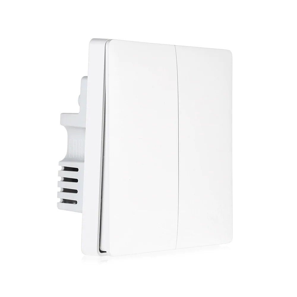

Iāve started having strange problem with aqara line double switches - right button doesnāt trigger flows, and not updating it status inside homey app, what is strange everything worked fine and problem appeared several days ago. I am not sure if it is problem with homey 5.0.4 update or something happened with this application. Any ideas how to fix this or who is culprit?
homey version 5.0.4 and app version 1.2.6

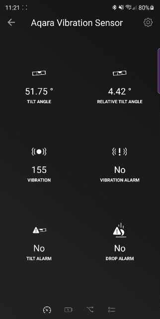

Today I (had to) reset my ZigBee network because of CVE-2020-28952.
After adding my Aqara vibration sensor again this App (v1.2.6) only reports the vibration alarm (not the tilt/drop alarms, nor any angles - it did report them before).
How can I (or Ted) fix this?
Idk, but the 1st step is to remove the battery for about 10 mins and try again

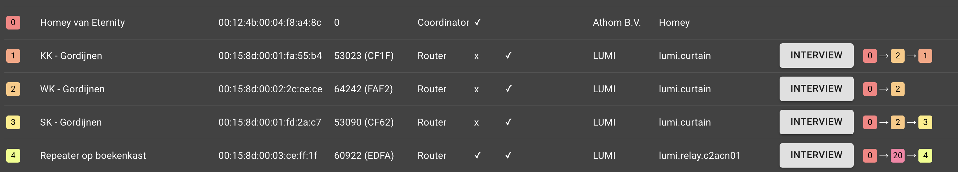

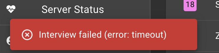

I have a strange issue with my Aqara curtain controllers (mains powered). In the developers zigbee page all 4 are stated to be offline. An interview times out.
They fortunately do work!
The Aqara relay is seen as online in can be interviewed successfully.
Is this just a zigbee Athom thing?
Patience was all that was needed
Except for the drop alarm all attributes have a value nowā¦
(and since the sensor is glued to a flap on a mailbox I donāt expect it to drop)

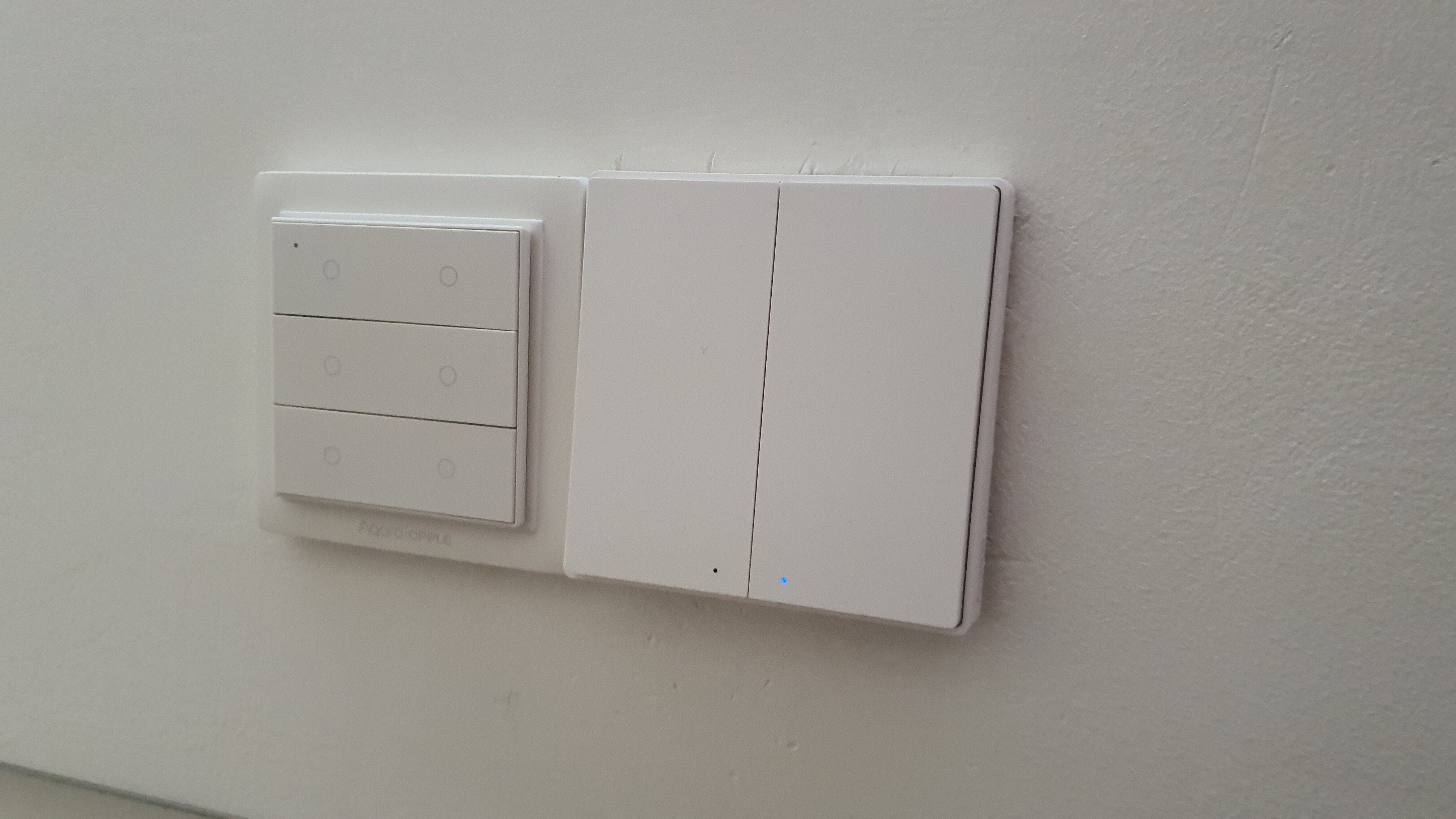

hello! was wondering if anyone might be able to let me know if the following functionality is possible with this zigbee switch via the Aqara Homey app.
Iād like to install this to replace my existing bathroom light switch and use the left button to turn the bathroom light on/off, while using the right button to trigger my bathroom Sonos speaker to play/pause a favorited radio station. Has anyone managed to do this? or, if itās not possible, can anyone make a recommendation for how to achieve this with Homey and some other smart switch? thanks
is there any easy way to check this? iām in Norway and suspect that probably most things have a neutral wire as theyāre fond of safety hereā¦
