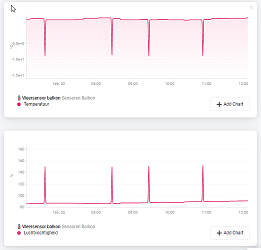

Has anyone had the same problems with the Aqara temp/press/humidity sensors (square ones) as below? 3 other sensors work flawlessly.
Bathroom (see below)
Humidity shortly peaks at 654,4% (increase of 619,5 %)
Pressure shortly drops to 990mbar (decrease of 1 mbar)
Temperature shortly drops to -100 °C (decrease of 120,8 °C)
Balcony (see below):
Temperature shortly drops to -14,59 °C (decrease of 39,52 °C)
Humidity shortly peaks to 184,08% (increase of 94,28 %)
Already repaired and replaced the batteries. I am on Homey v5 rc59.
Would both sensors be faulty?

I had a similar issue. In my case I think the cause was that the sensor was at the edge of the range, outside under a shelter. Humidity spiked sometimes (also to 654,4%), interval of update in values showed variation although the temp changed, only humidity and pressure changed and not the temp (although there actually was a change). Thought the sensor passed away and bought a new one.
Placed the ‘old’ sensor inside, more close to homey, changed the battery, the sensor itself dried up (the mist caused humidity in the sensor I think) and now it seems to be working again. Placed the old and new sensor a few cm apart from each other indoor to do some parallel testing. I have bought an extra router device and will start testing outside again after it is in.

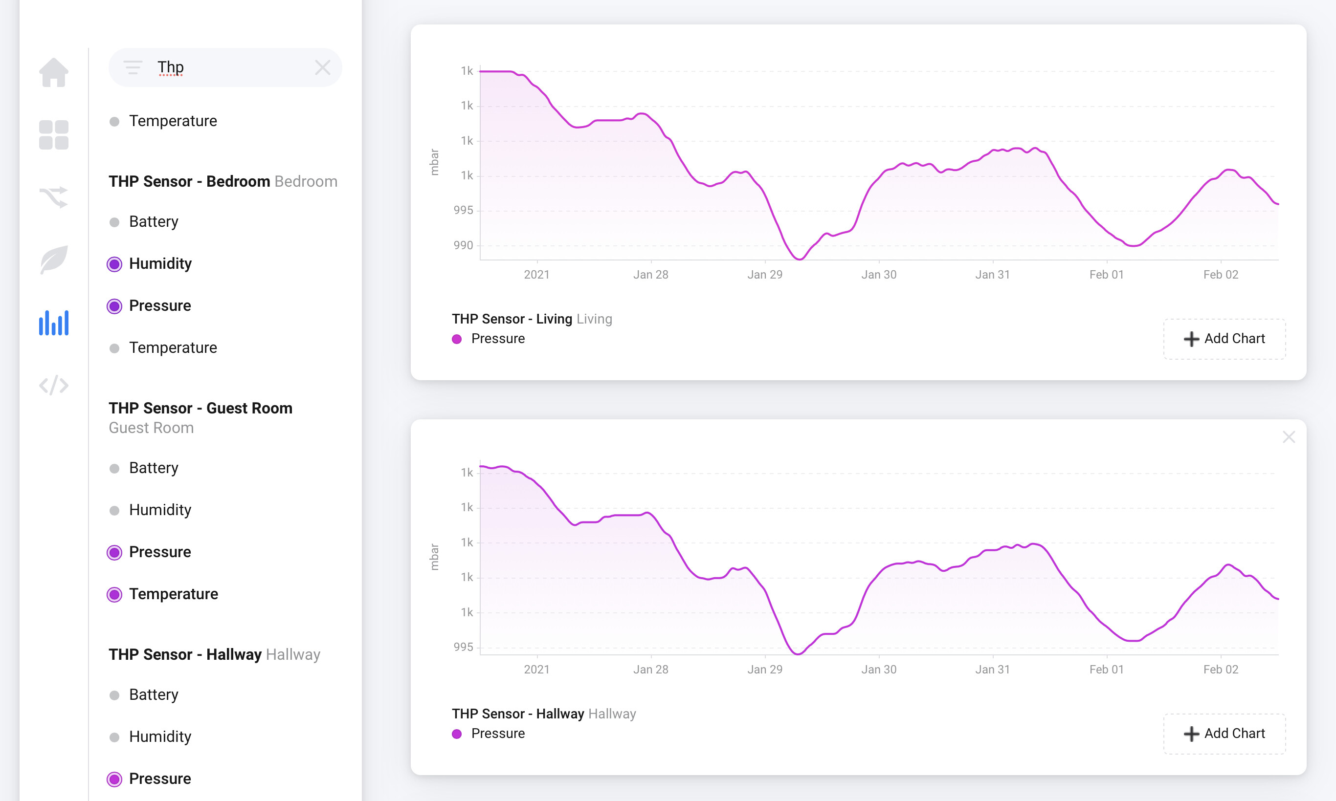

No issues with 4 of them, of which 1 in the fridge (-18) and one outside (sheltered).
The sensor in the fridge even follows the outside pressure trend nicely. :slight_smile:

No, from time to time these sensors send a wrong value, which will be filtered out in the next update. Also happens on other platforms.
