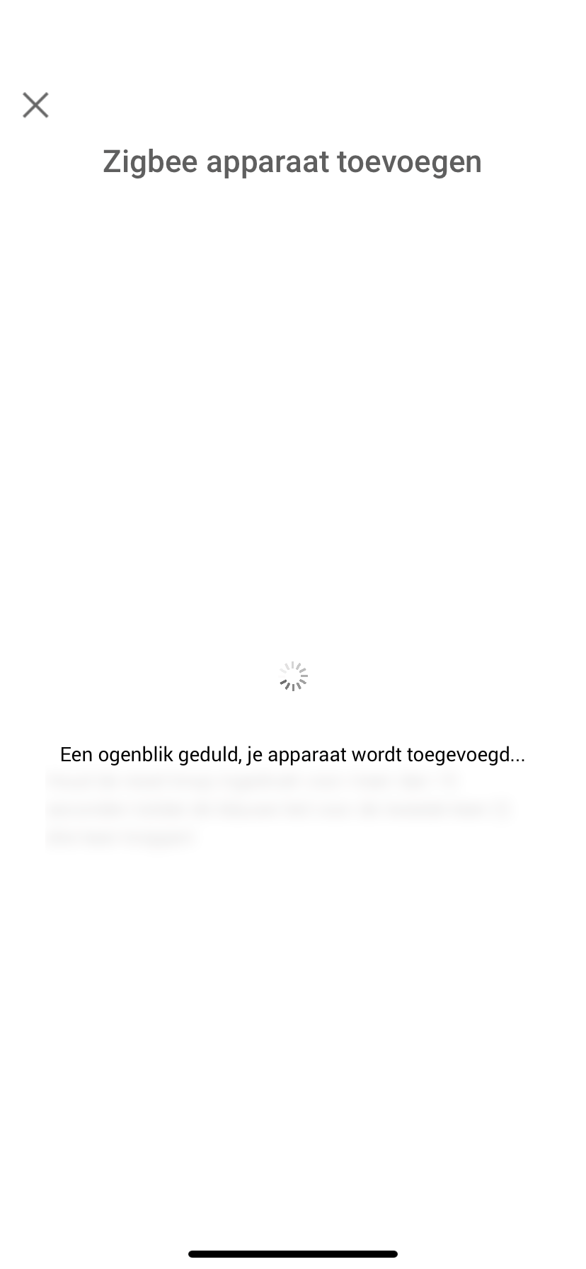

Gentlemen, I am already afraid that I know the answer, but would still like to make use of your expertise. I have 2 “Aqara Polle” switches (2 and 6 pushers).
I will nog get it paired anyway. I have performed the PTP (several times) but “did not get it right”. I also notice that I am experiencing problems with connecting Fibaro (failure is at Athom) and Innr.
Yesterday I managed to find it once but got the message “device is not responding anymore”.
Am I forced to reset the Homey?

Can you try not to include the Zigbee device in close proximity of Homey, but close to a (verified) working Zigbee router?
Ted first thanks for the support. Yes I try it a few times today.
I keep the Opple 10 cm from the ‘router’. Nothing happens :cry: (

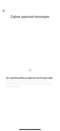

Trying to add a new Aqara Window/door sensor. No luck, cant get past the inclusion screen. Have 5 similar other devices working as a charm (thanks ted). Any suggestion how to add the new one? The others were added pre 0.8 v and homey 5.0.
Yes, PTP and try it immediately after. I added like 6 devices like that recently.
