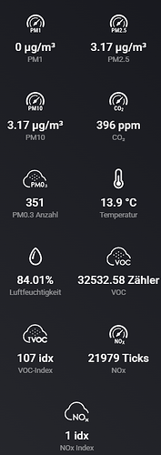

Immediately after inclusion all sensor values are available, but some of them may need a short time to adjust, so give it a few minutes.
The values react quickly to any change in the air as you can see below, when one of our neighbours starts burning old tires (or whatever):
