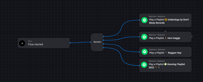

I would love to see a random node like this!
What do you think?
