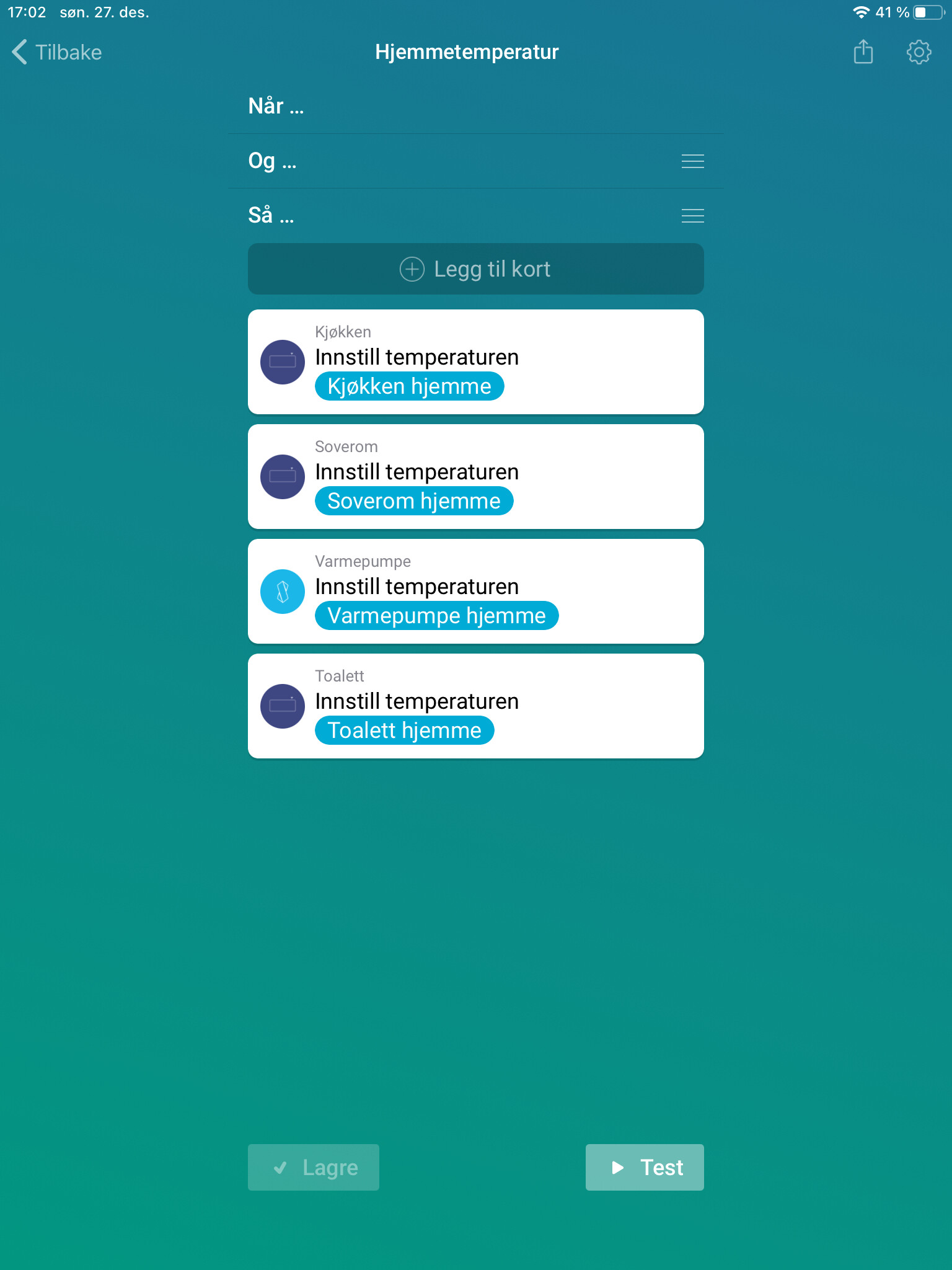

And what is behind the Flow “Hjemmetemperatur”?

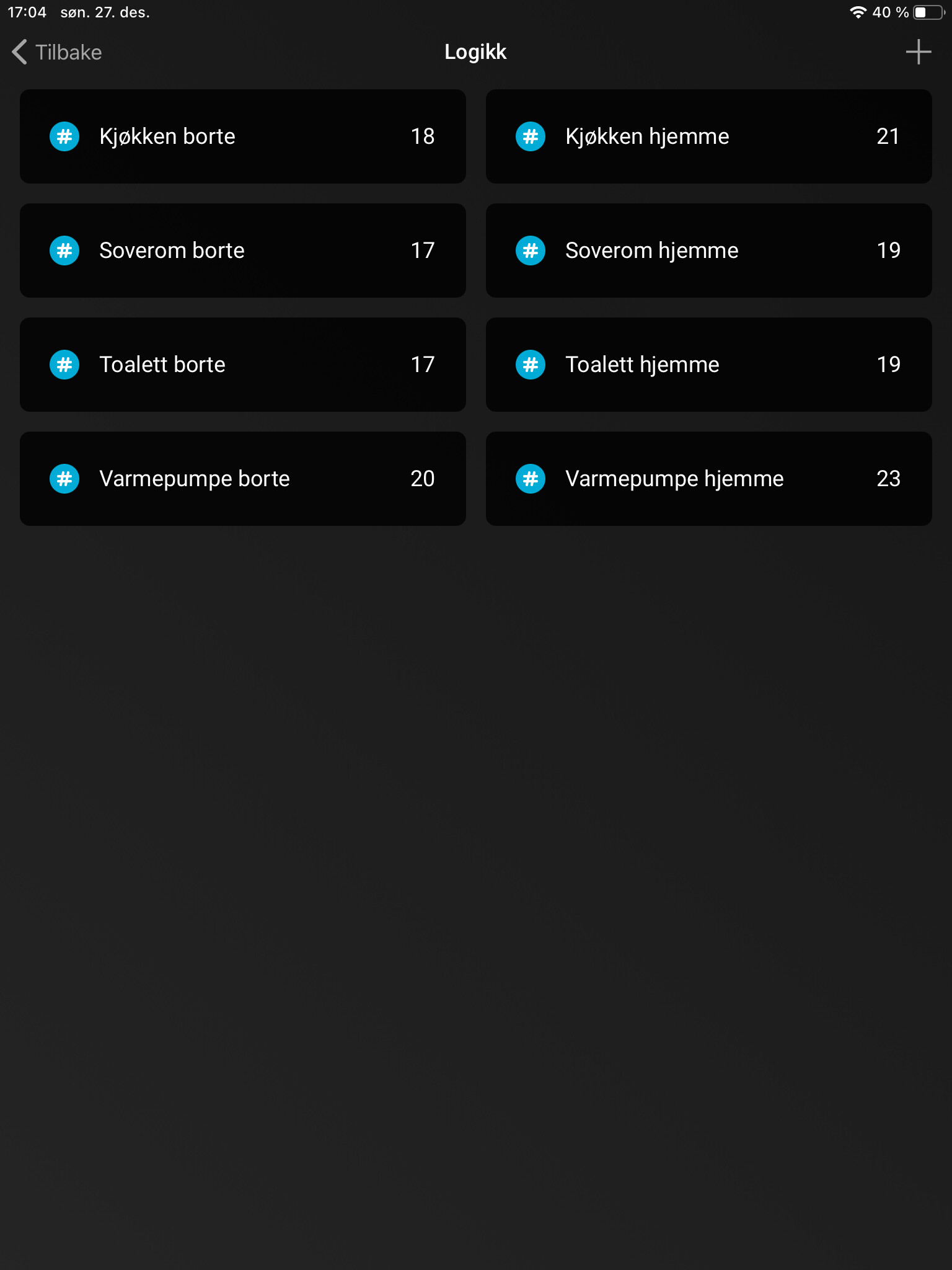

Hjemmetemperatur is just commands to ac and panel ovens to set to a temperature i have stored in Logic
