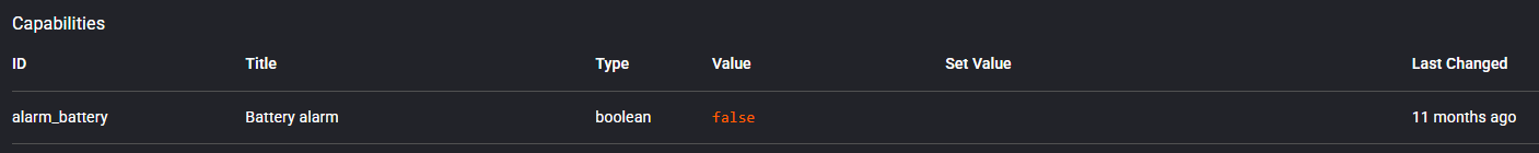

I have the same “issue” with all (12) my other Philips Hue Dimmers. And looking via the Developer Tool the details of the Dimmers, I realize that the “last update” reported by the script could actually be the “last changed” date of the battery alarm ?
Is is possible ?
Some Dimmers with last battery alarm = 11 months
Dimmer guest (18-02-2024, 11:30:24 - remote) (NOK)
Dimmer bureau (15-02-2024, 16:39:05 - remote) (NOK)
Some Dimmers with last battery alarm = 8 months
Dimmer Klara (19-05-2024, 09:08:32 - remote) (NOK)
Dimmer 1 (19-05-2024, 11:07:26 - remote) (NOK)

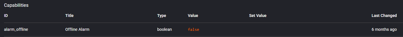

PS: I realize I have a similar behaviour with “homey:app:com.netscan:ip_driver” devices… The “Last Update” date is the last “Alarm” (“Offline Alarm” for NetScan devices)
Camera Living (23-07-2024, 23:42:51 - sensor) (NOK)

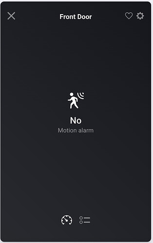

I’ll look into tomorrow, it’s working ok, as is the front door sensor that doesn’t show any battery level.

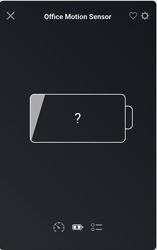

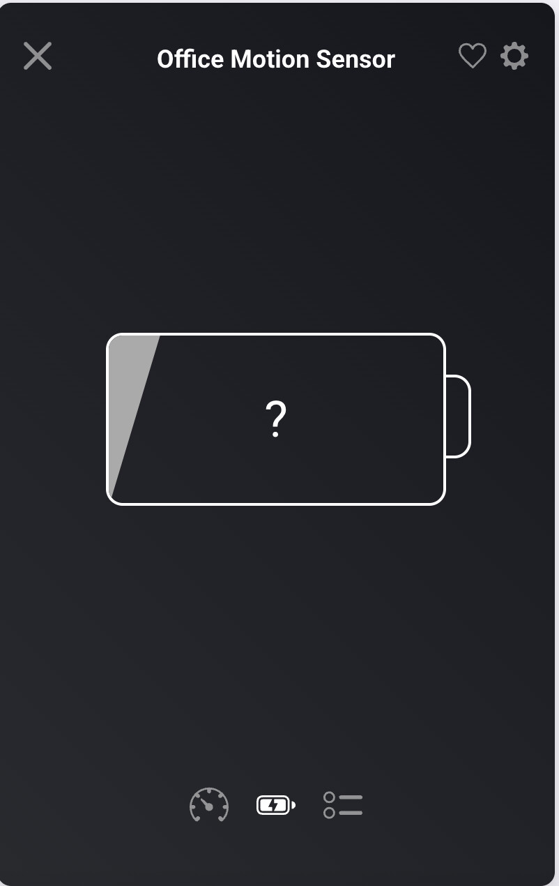

Come back to this after some personal distractions, and same after running script 0.8. Checked Homey Device Status on the Front Door and Office Motion Sensor, both are IKEA TRADFRI motion sensor running firmware 2.0.022. Looking at Battery Status in Device Settings both show the same image of Battery ?. Any thoughts @Sharkys (Many thanks)

Some IKEA devices don’t report battery state, check the device settings
