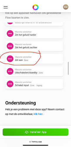

I have a marantz SR 7012 AV. Is there a option to switch or trigger my second zone in the AV? In the marantz app this option was availlable but the app isn’t supported for Homey pro 2023.
In the heos app i didnt find this option witch is strange because the original heos app had this function.

The ‘renewed’ heos app is aimed at heos devices, not on all functionality of a/v receivers with heos. Only basic functionality is available.
But afaik the heos app is still w.i.p., you can inform with @Caseda if it’s possible to add zone2 control.

You can also try the Denon AVR app. Denon and Marantz are basically the same. Don’t know if your receiver will work, but I have a Cinema 50 and it works like a charm.

I’m using the Denon AVR app to control my Marantz AV’s second Zone with special commands Z2ON and Z2OFF, works pretty good.
I haven’t found the special command to set the ‘All Zones Stereo’ option. If someone knows this command, please let me know!
Well, to answer my own question and for information to others: The command for ‘all zone stereo’ is ‘MNZST ON’
