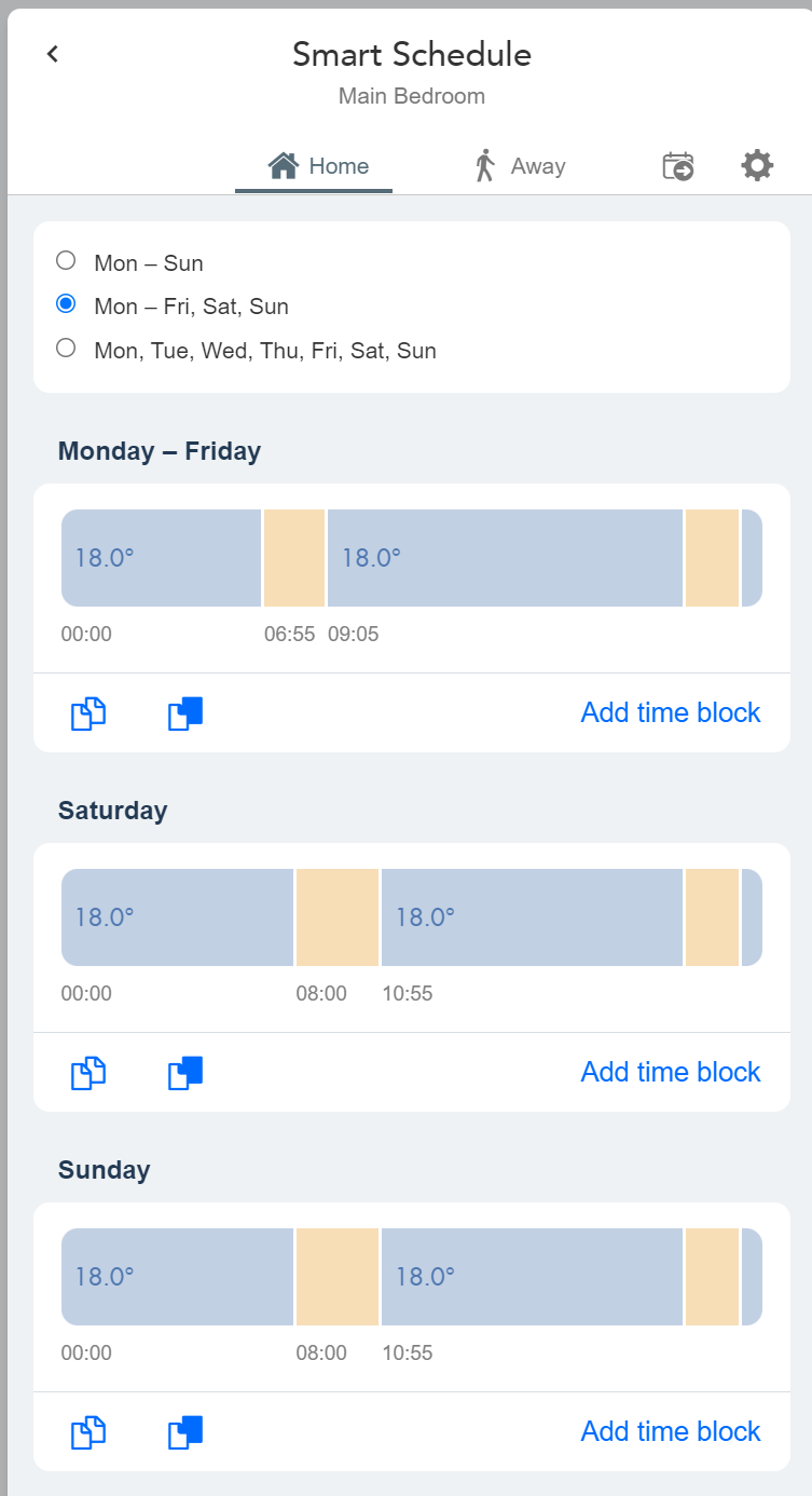

They made it less than 3 months. I don’t think it’s a particularly challenging task for for this radiator - the tado receiver / dongle thing is in the next room, less than 4m away and the schedule is very straightforward:
