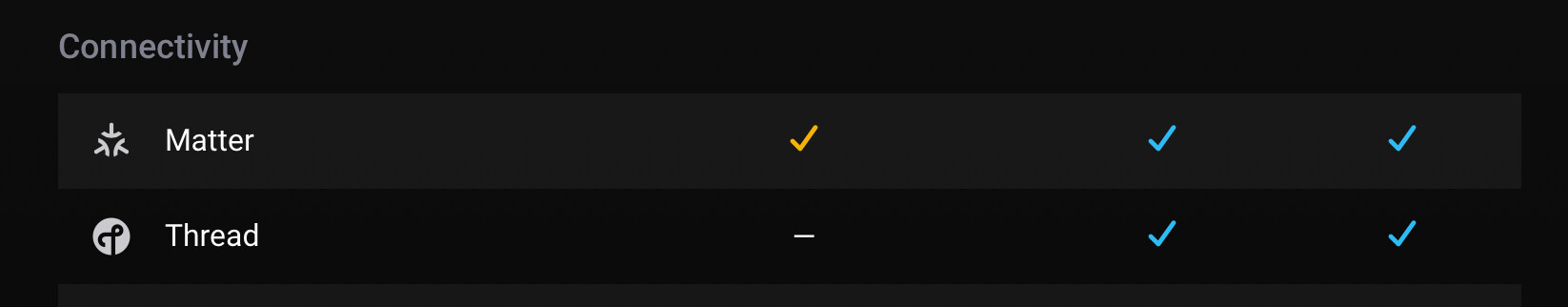

connecting devices, yes.. but becoming a member of an already existing thread network no
Due to this shared hardware, Homey Pro currently can’t join an existing Thread network (such as one created by Apple Home or Google Home), as it may conflict with Homey Pro’s Zigbee network.
that’s what i meant

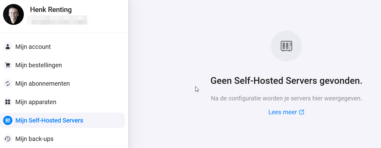

That’s it? Just this short video? No further explanation by Athom employees?
But: Got it!
(had to update my Homey phone/tablet app to be able to add a SHS)

My question (linked to the discussion above): the SHS page says Thread is not supported by Homey SHS. But can I still add a Matter over Thread device to Homey SHS by using the “Connect via Android/iOS” option in the Homey mobile app and using existing Thread Border Routers (HomePod Minis in my case)?
