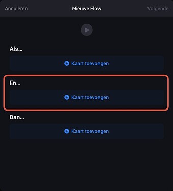

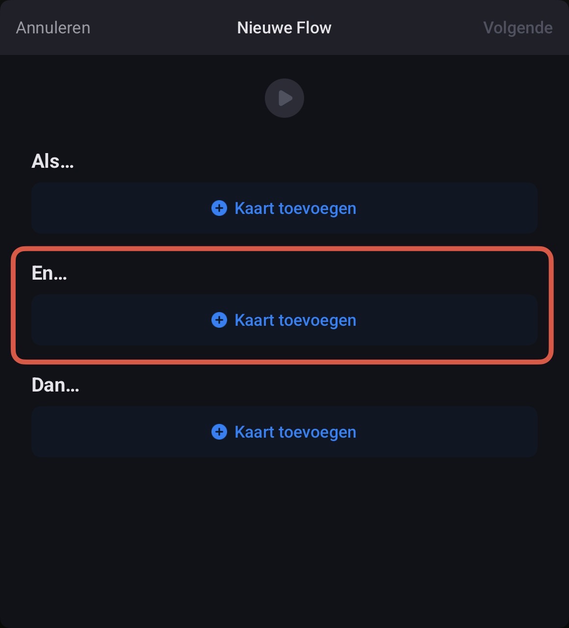

That knowledge article relates to Standard Flows. The term ‘group’ refers to the section as indicated in the screenshot.
If you look at the standard structure of such a flow it has 3 sections: WHEN (Als), AND (En) and THEN (Dan).
The AND section/group contains flowcards that check whether a condition applies, for example the temperature is higher than 20 degrees.
Normally all conditions that you include in the AND section need to apply in order for the flow to continue. You can however also contain an OR condition as explained in the knowledge article. In such a case either of the conditions need to apply, instead of all.

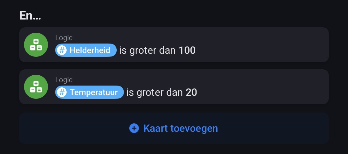

Below an example with two conditions. In the first screenshot both conditions (luminance and temperature) need to apply (AND). The second screenshot either of the two need to be true (OR / Of).
