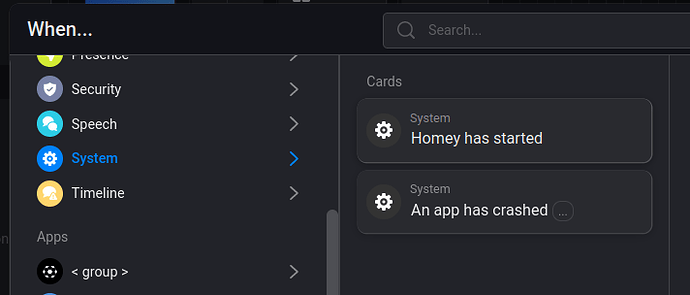

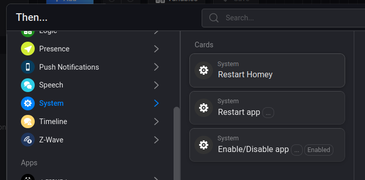

How do you trigger an app restart in a flow?
Enable Power User (…More > Settings > Experiments)
Then, the item called ‘System’ becomes available in the flow editor.
Something like this Hugo?
Yes, something like that.
I don’t use advance flows (yet), but it looks like what i do.
Perfect! It’s going to be interesting to see what happens this weekend! :grinning: I’ll let you know. :+1:
I didn’t even know about the “Restart app” or “An app has crashed” cards. I did a flow with where I collected all the apps that I have experienced problems with that states When “An app has chreshed”—>Then “Restart app”.
