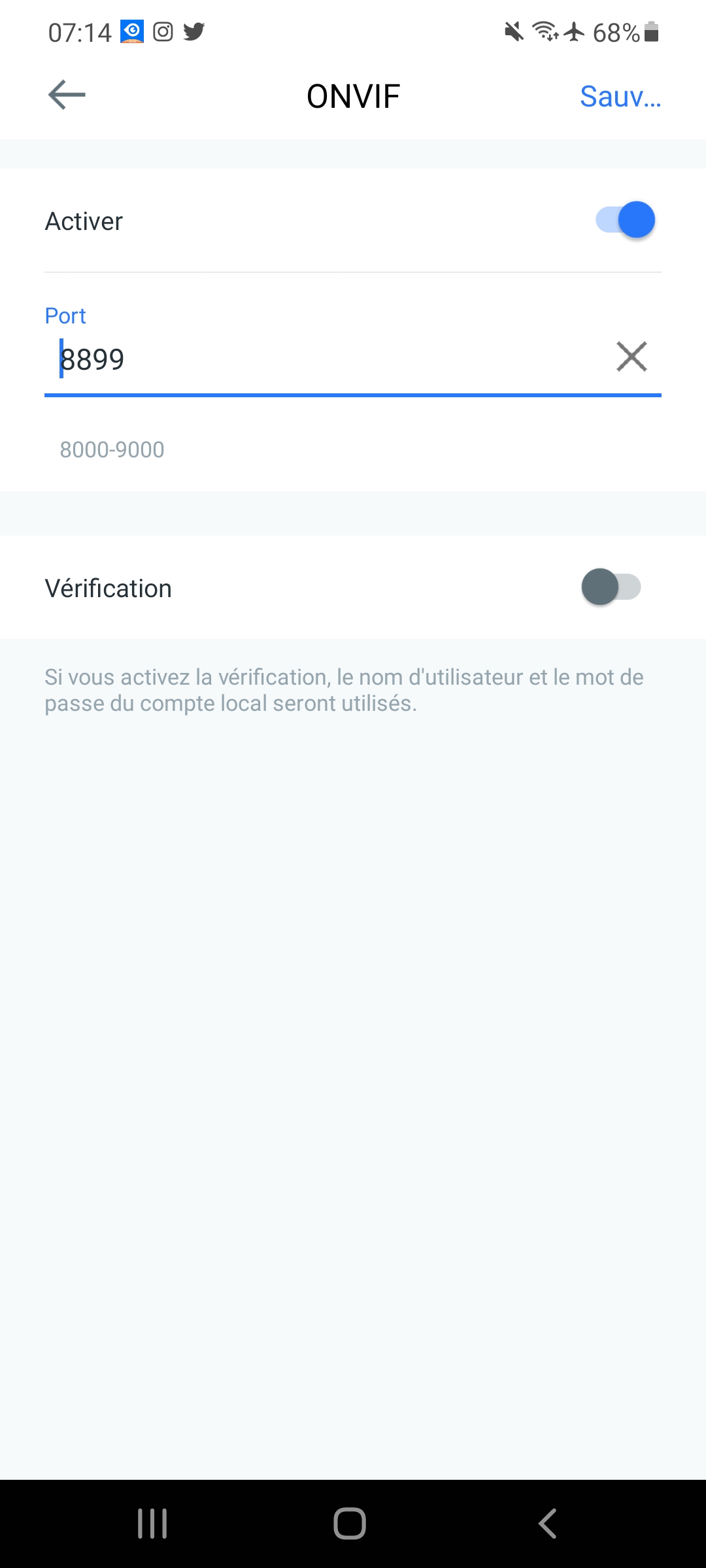

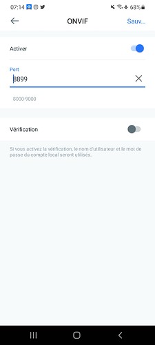

First activate onvif on the cam in wansview app
Uncheck security or it wont work like in screenshot
Then add the cam via the onvif homey app. Use the ip of the cam, port and your wansview username and pass
