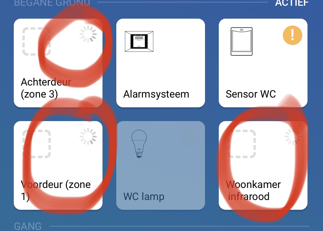

After the update today (homey
2.0.3) the sensors doesn’t work anymore.
Are there more users with this problem?
Is there a solutions for this problem.
I have got a lot of flows with the sensors.
Yes same problem here.
Yes, same here. I had to remove my panel and re-add it again and after that I see most of my sensors, but a couple of them are not recognized and showing as unknown in the logs when I re-added the panel.
With app version v2.0.4 update today all the sensors are now working properly. Thanks for the update.
