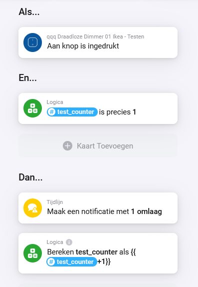

Maybe you can make a counter
IF button pressed
AND counter is 1
THEN curtain down
Add 1 to counter_curtain

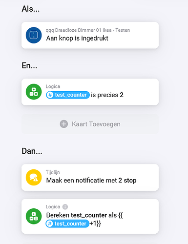

IF button pressed
AND counter is 2
THEN curtain stop
Add 1 to counter_curtain.
IF button pressed
AND counter is 3
THEN curtain up

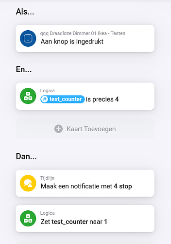

IF button pressed
AND counter is 4
THEN curtain stop
IF counter is 5
THEN set counter_curtain to 1
You have to make a Variable counter_curtain.
Calculate counter_curtain als {{counter_curtain+1}}

Can I control that with just 1 button?
@rihanna Did you test this already?
This works with one (hardware) button.
I tested this on my timeline but you have to choose for Up, Down and Stop.
