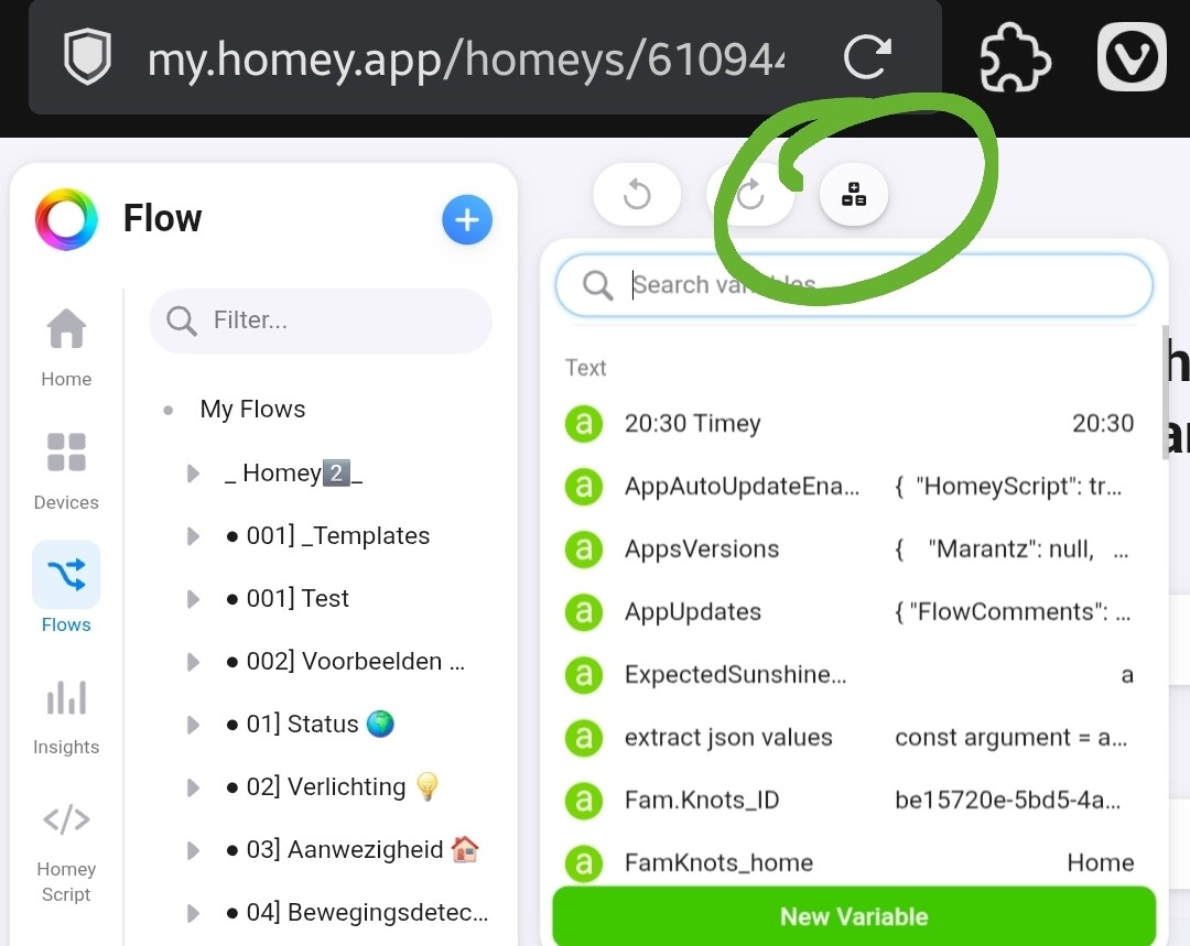

The actual value of variables can be viewed per mobile app at ...More > Variables
and per web app:
This happens, when no value or an invalid value has been assigned to a variable. Set it to a valid value (e.g. 1 for a numeric variable) and it will show that value instead of the gray 42.
